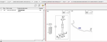

E60 sway bar part number is hwa1243230165
Here it is
The number is difficult to read but it looks like B6 602 00 41
Jeff
This is easy to read

Here it is... The number is difficult to read but it looks like B6 602 00 41
Thanx Jeff, this is what I got 30 mm too. According to receipts mine is B6 *** part number.
Rick whats the difference between HWA*** and B6 *** part numbers , I guess B6 is a newer version of part number ?

HWA part numbers are used for items on production cars. The HWA part number is still listed as valid in the EPC.
B series part numbers are normally optional items and/or kits to install/convert "after the fact". You need to access the SA to find the B listed part numbers. Kind of a pain in the ass via the EPC.
The E60 suspension conversion kit does not list the sway bar as part of the kit, so not sure exactly where the sway bar B part number came from.
With that said. There shouldn't be any different between the sway bars themselves, but sometimes the B series are "kits", so it might come with bushings and/or brackets (just a guess though)

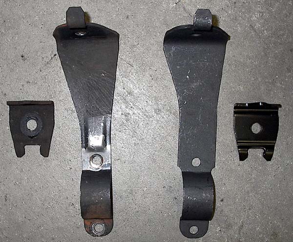

Another thing I would really like to see would be a Proper/Solid chunk of aluminum to Hold the sway bar to the chassis instead of that spindly sheet metal bracket..:-P
jono
Agreed. The factory bracket is pretty wimpy, even though they redesigned it... the original was so bad it often broke! The new version isn't much better, but at least doesn't break as often.
Old style on the left, new/improved on the right:

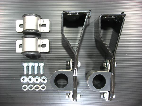

Some folks in Japan came up with these... not my cup 'o tea, as they don't use OE bushings:

the jap ones look Interesting, but yea..having to source their bushings to make it work/have some made when they wear out pulls the want factor down a few notches.
I figure w/ some chunks o' alloy you could have it machined up to take the factory bushing size/shape..be it rubber or poly..:)

Hi,
The swaybar brackets are designed to withstand fatigue conditions. The swaybars fixed end into the LCA does in reality have a pendulum movement around the axis in the front bushings. So the bracket functions like a spring plate allowing to flex back & forth just a bit, along with the swaybar end "vertical" movement. The reason for beefing up the design due to breakage is probably a good explanation itself, they were too weak over the flexing section, or too weak material.
Using aluminium is not possible due to it's low elasticity modulus (spring effect), they will break pretty fast - unless they are totally redesigned. That Japanese bracket are too rigid and will likely break just above the upper bolt hole where the two plates are mating, because that is the weakest section taking all flex out from a structural perspective. Additonally they are even welded on the edges, causing a more brittle structure in the material, which is an ideal point to start cracking up.
It is no point having these brackets as rigid as possible, they need to allow some flex spread over a certain length. The brackets main function is simply to hold the swaybar up in place, and undertake stretch and compression loads. The bushings is another story, but keep in mind that the 036 is NOT a race car, so harder bushings may be noticable, but is more a individual gut feeling IMO.
To save weight on these brackets by maintaining a identical design, and achieve necessary rigidity, titanium is probably the best choice. But the weight savings is minimal anyway.
