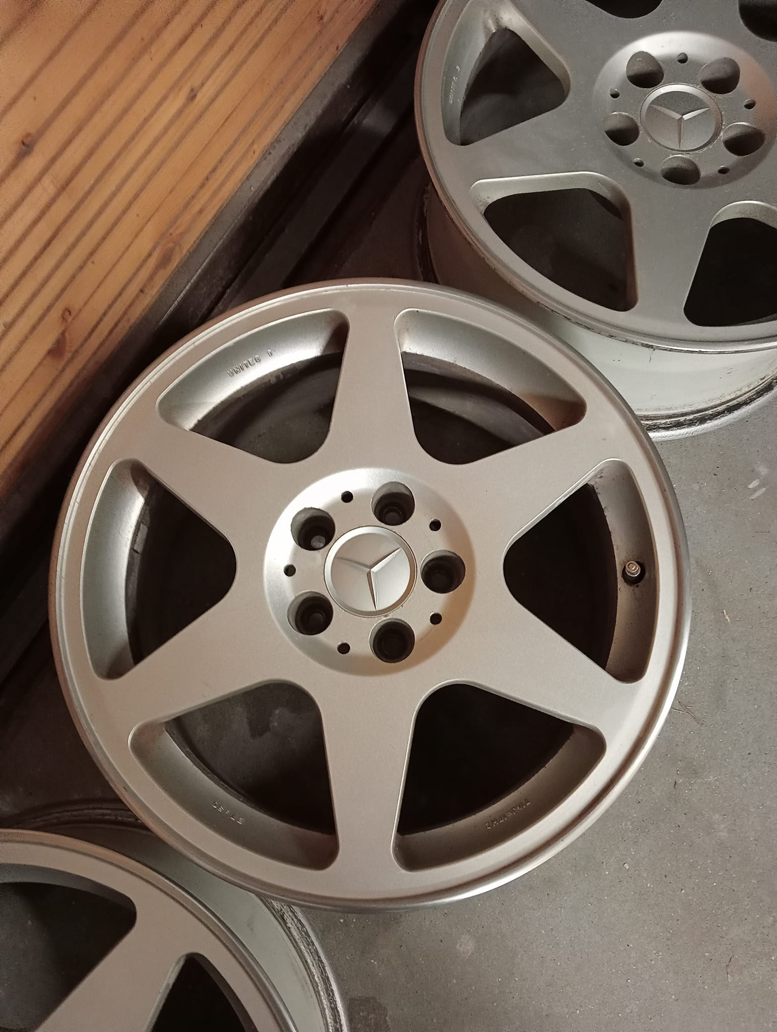

Straight from my wheels in the R129. Unless they are counterfeit, the 1995 Special Edition SL came with Evos.
R129 factory Evo wheels should be 8.25", ET34, same as the E500 Limited (and W201 Evo II).
Google search indicates these appear to be aftermarket wheels, not Mercedes... and, 7.5" is incorrect width for any R129. Wheels on the R129 should be a minimum of 8.0" wide, same as the E500E.
Photo below... these are aftermarket. Factory Evo wheels have the specs stamped on the back side of the spokes, not on the front side.
