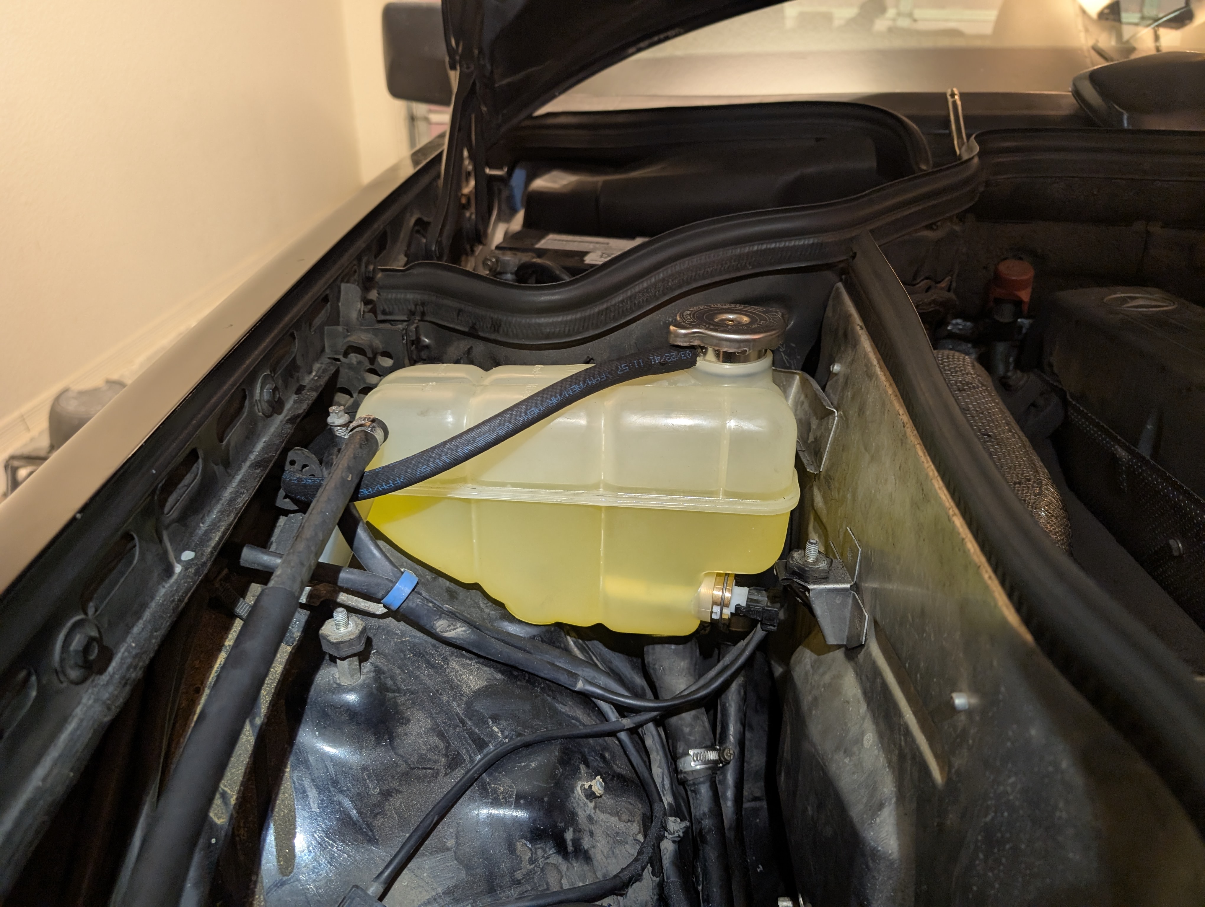

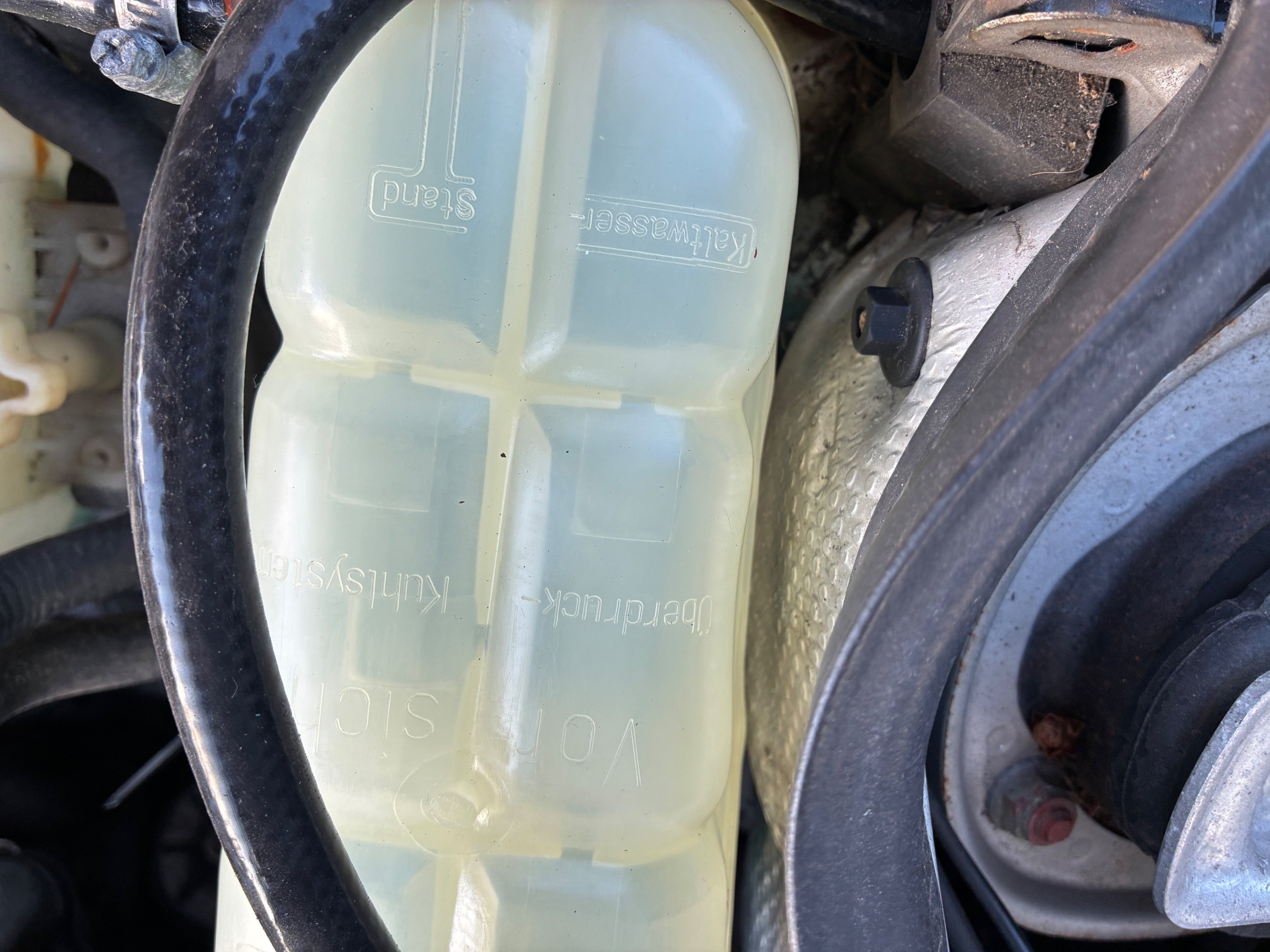

Hi guys,
I'm coming in a few years later on searching for parts and a lot are NLA.... Tried everywhere without success... Does someone here has an Expansion Tank 1245001549 laying around that is willing to part with please???
Picture for reference.
Thanks a lot!!!!!!
PD. Does anyone knows why all the MB sites when looking for 124 parts they throw you to 210 catalog?

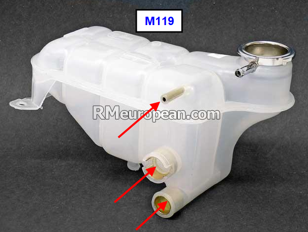

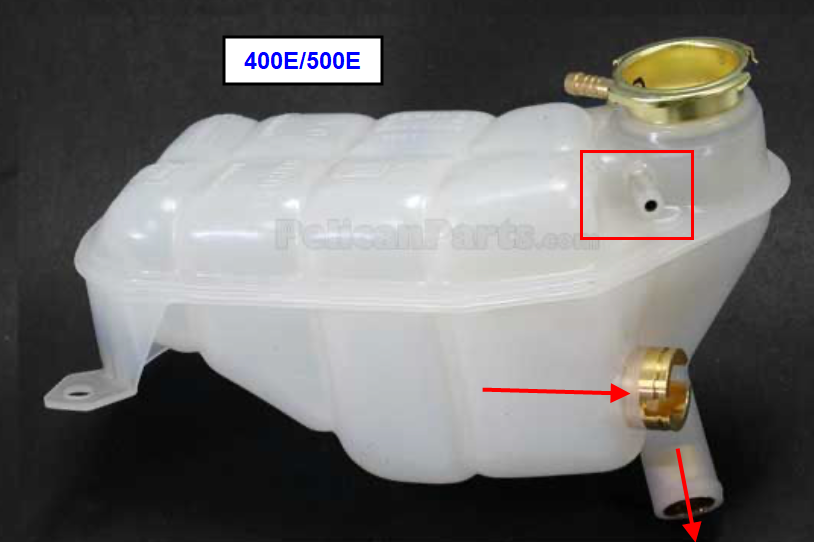

126 chassis reservoir almost certainly will not fit. There may be some aftermarket (Febi) tanks for other 124 chassis which MIGHT work. Maybe. I don't know, I've never tried.
:klink:
A standard w124 tank with partsnumber 1245001749 will fit with some minor mods.
Not ideal,but better than no tank if not available .
Tank 124-500-17-49 is for most 124 chassis with M103 engine. The location of the sensor & hose connection are slightly different. Looks like this may still be available per the MB Classic site, although some vendors show "NLA". I wonder if this had been NLA but came back to life? Some sellers on eBay are asking $250-$350 but MSRP in USA is only $53.

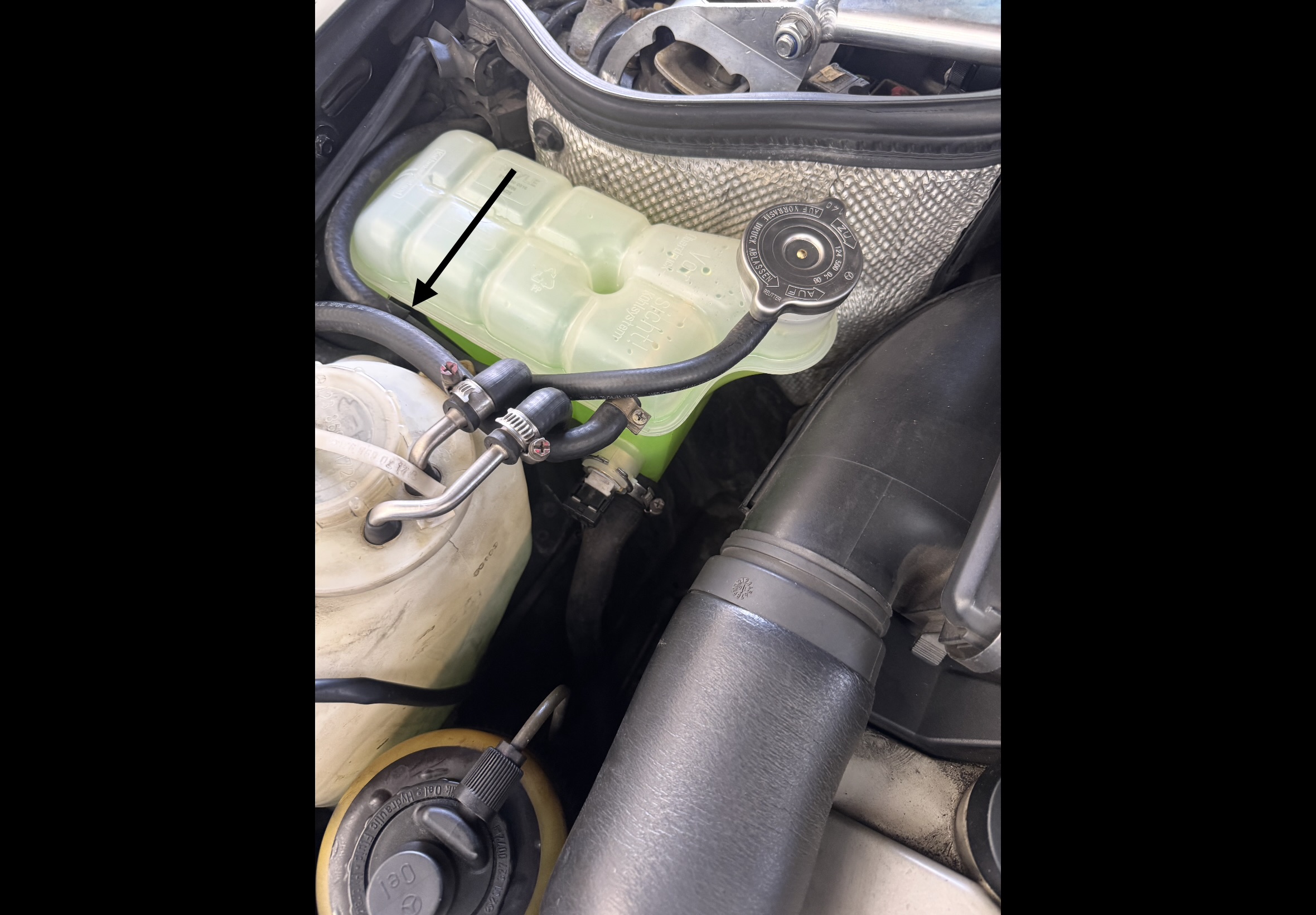

Hello,

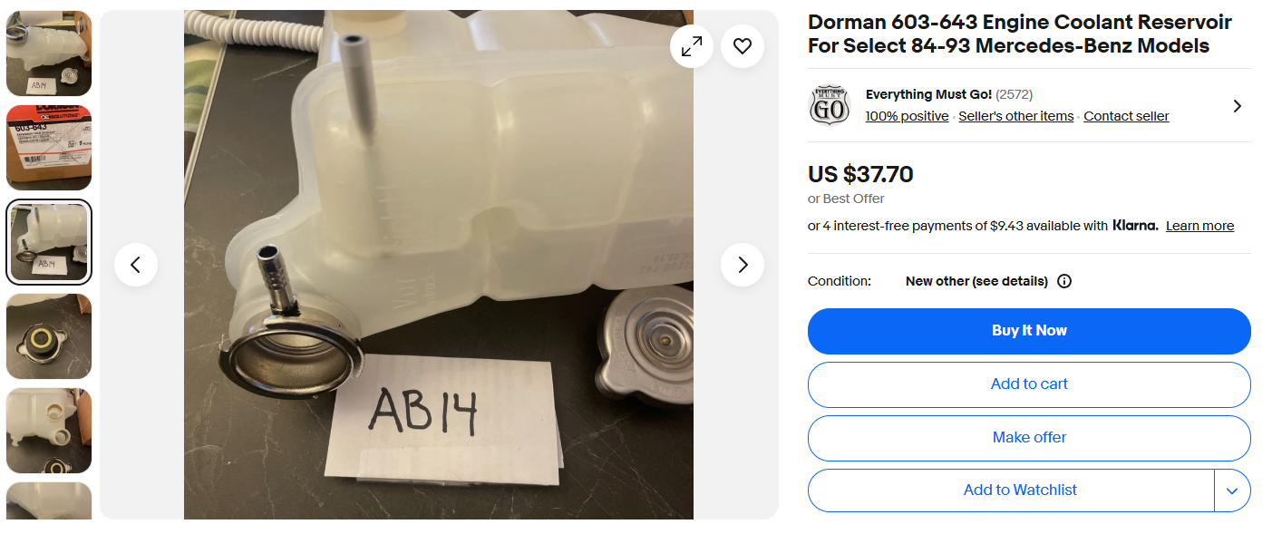

Just wanted to let you guys know, the Dorman part# 603-643 is actually a much closer match to the original even though in display pictures it shows like the incorrect one shown above in @gsxr 's post.. I'll add a picture in the morning to show once installed, the level sensor and outlet port are in correct orientation, only the bleed port and vent port are different but totally usable...
Cheers
I found photos of the Dorman here... looks identical to the M103 tank? If so, might as well get the OE tank for the same price.

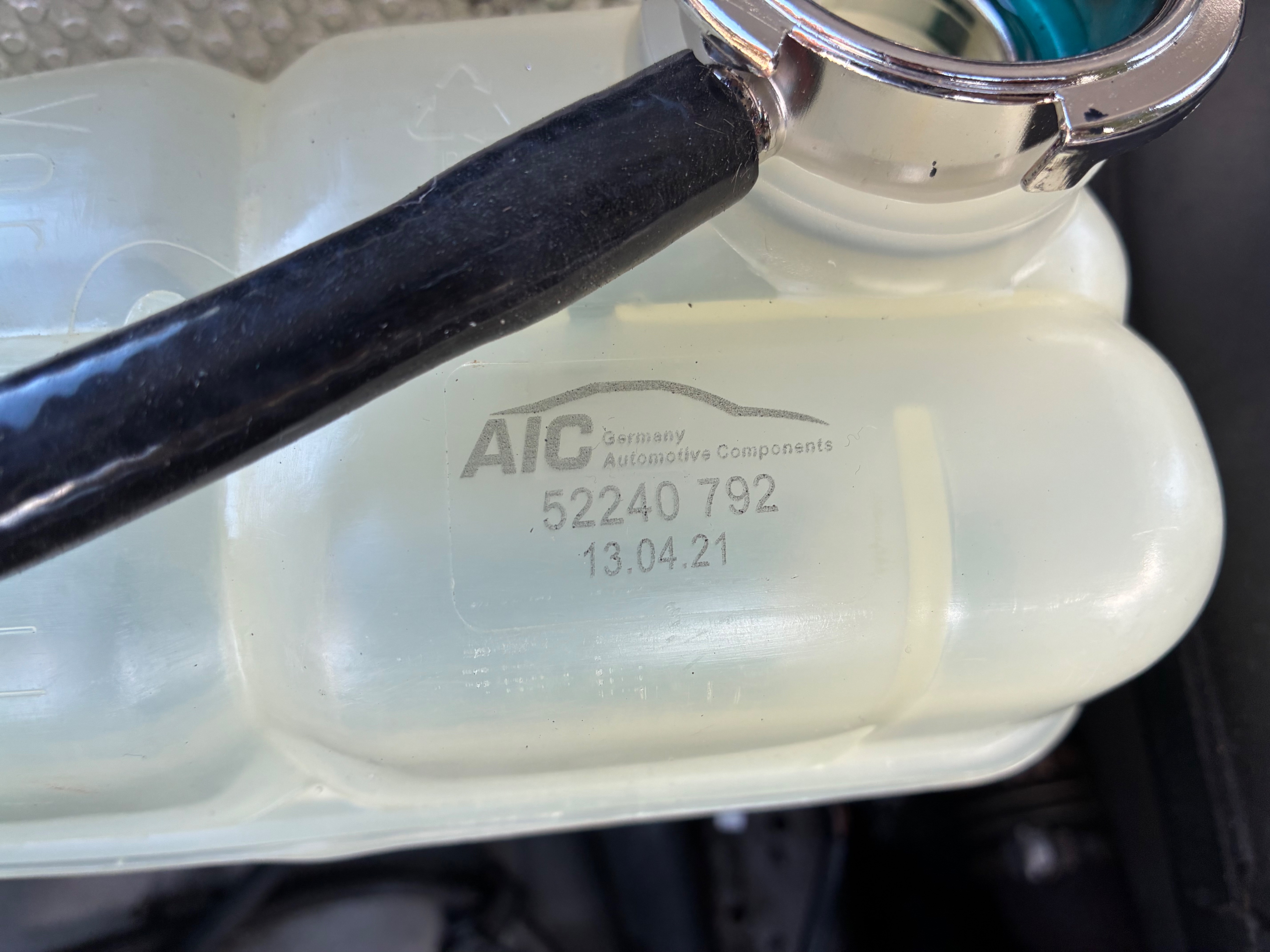

I got something different for sure… don’t know if they sent the wrong part but was ordered off Amazon under that Dorman part number. The bleed port hose has plenty of length to comfortably reach the new location on new part
Welp install was great, fits perfectly, I did change out bleed hoses for silicone with a bit more length to be safe, stoked on it for $30! Took pics of what part numbers are on it, I’ve found 90% Dorman parts end up being German made or exact OEM in last few years…
