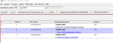

Note the 4.2L EZL's have a model year / VIN break for each part number, the 012- and 013- modules are for the lower compression 4.2L engines used on 1992 model years. I was never able to figure out the difference between 014- and 015- but suspect it may be related to the change to open-deck blocks? The chassis break (B965057) is very close to the 1994 model year break, but there were no substantial engine changes related to the model year.
