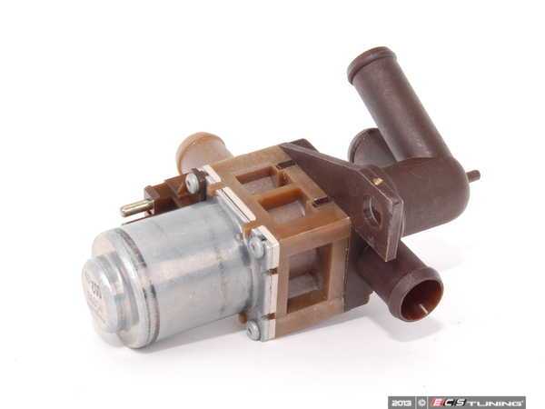

I did test the air sampler and that's working, I also swapped in a spare push-button console because I had one - no change. I'm guessing most of the problem here is a failing mono valve, I have yet to verify whether or not it's seeing voltage though. I have the late production valve so the replacement is going to be pricey, before I bite the bullet I want to be sure. Is there anything else I should be looking at? Has anybody ever had one of the late production valves apart?

I have experience in this- my a/c got colder when the mono valve was replaced. I would say it was leaking and not "on". Vent temps were ~ 50-55 and dropped to 40-44 F with a new mono valve. From my experience the EPC is incorrect on the VIN break. You need to see if your mono valve has 3 or 4 ports. Later are 4 ports and are EXPENSIVE new.

I apologize for disappearing but I did successfully rebuild the mono valve while I was away. Although the "full heat" with a/c problem hasn't returned I'm not entirely convinced it was being caused by the mono valve, however I did find some interesting things and confirmed my suspicions that the later 4 port valve can be rebuilt with soft parts from the earlier 3 port valve. Most importantly, it wasn't necessary to shell out upwards of $300 to get things back to normal; I have a ton of pics that I'll get around to uploading as soon as I find some time. In the interim here's a link to a really exciting video I made during the rebuild process:
