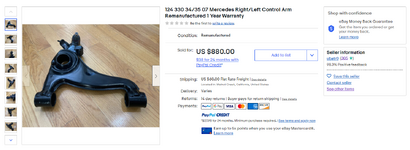

I hope these are actual OEM….
Is there any way you can return those and get your money back?
Yes, they are OEM, but the only thing "refurbished" about them is a new coat of paint and -
maybe - a new dust boot on the ball joint. For $950 they didn't even install new bushings?!!!! They are selling the new OE bushings separately for $225 each (
link, 2 required) when you can buy them from a dealer for <$150 each. Unbelievable. Note the ball joints cannot be replaced, repaired, or refurbished other than adding some grease.
Looking at their other listings (and feedback), it appears the seller is parting out an E320 and asking exorbitant prices for some items. ~$350 for door cards... $100 delivered for a single visor... $700 (
link) for an original wiring harness with bad insulation...!!!
Assuming you don't have the original control arms to refurbish yourself, call your favorite dealer and ask if they can still get any of 124-330-
36-07 and 124-330-
37-07, these are identical to the #34/35 except the #36/37 have stiffer rubber bushings. MSRP is $1k/pair but discount dealers have them for ~$700/pair. WITH new bushings and new balljoint.
