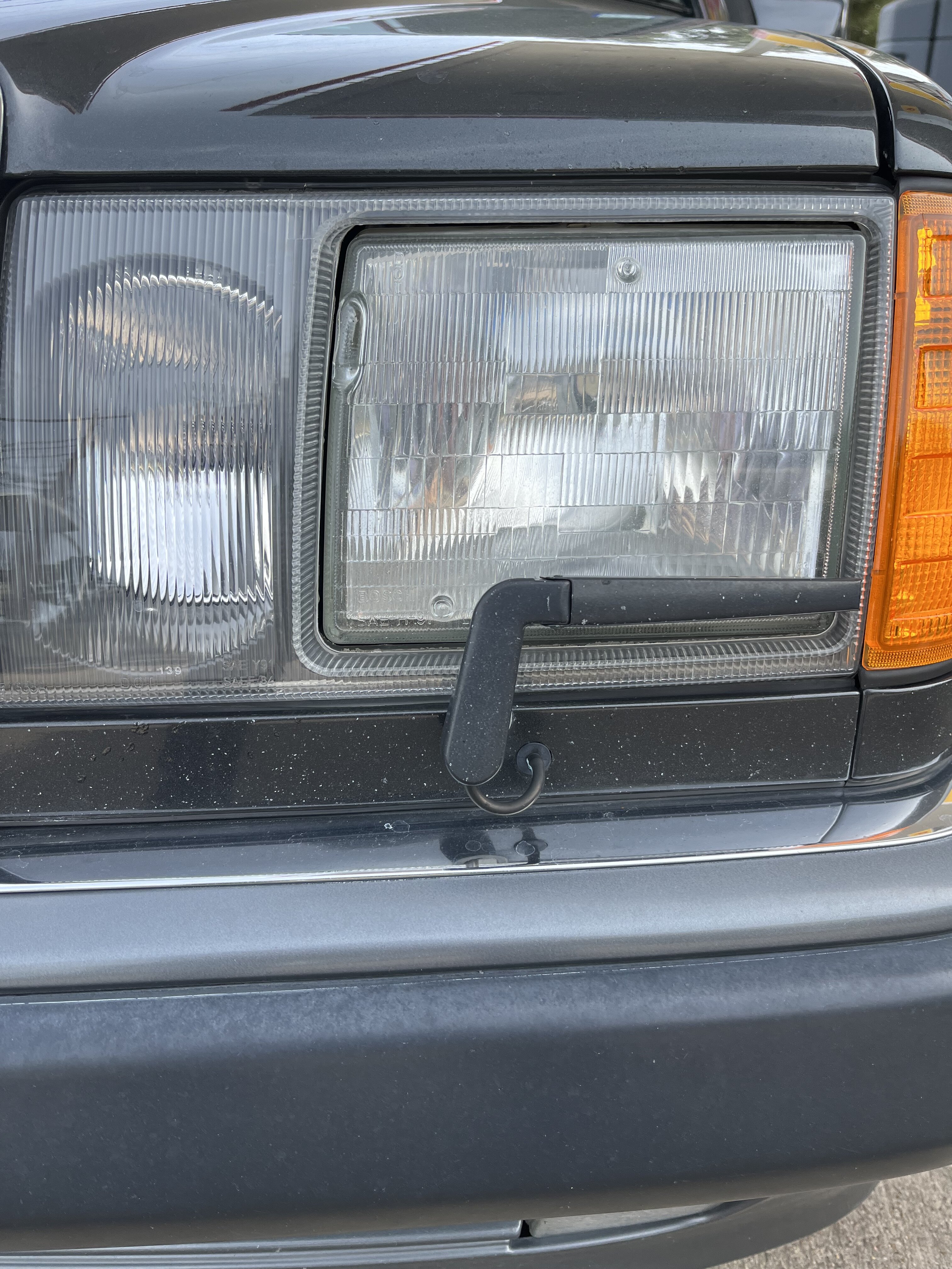

A picture is worth a thousand words...if you want a definitive answer, post a picture of the front of your car. :)
Raised notch means it’s US lights, I’d assume. Do your lights and wipers look like the attached?
Those are the USA lights.

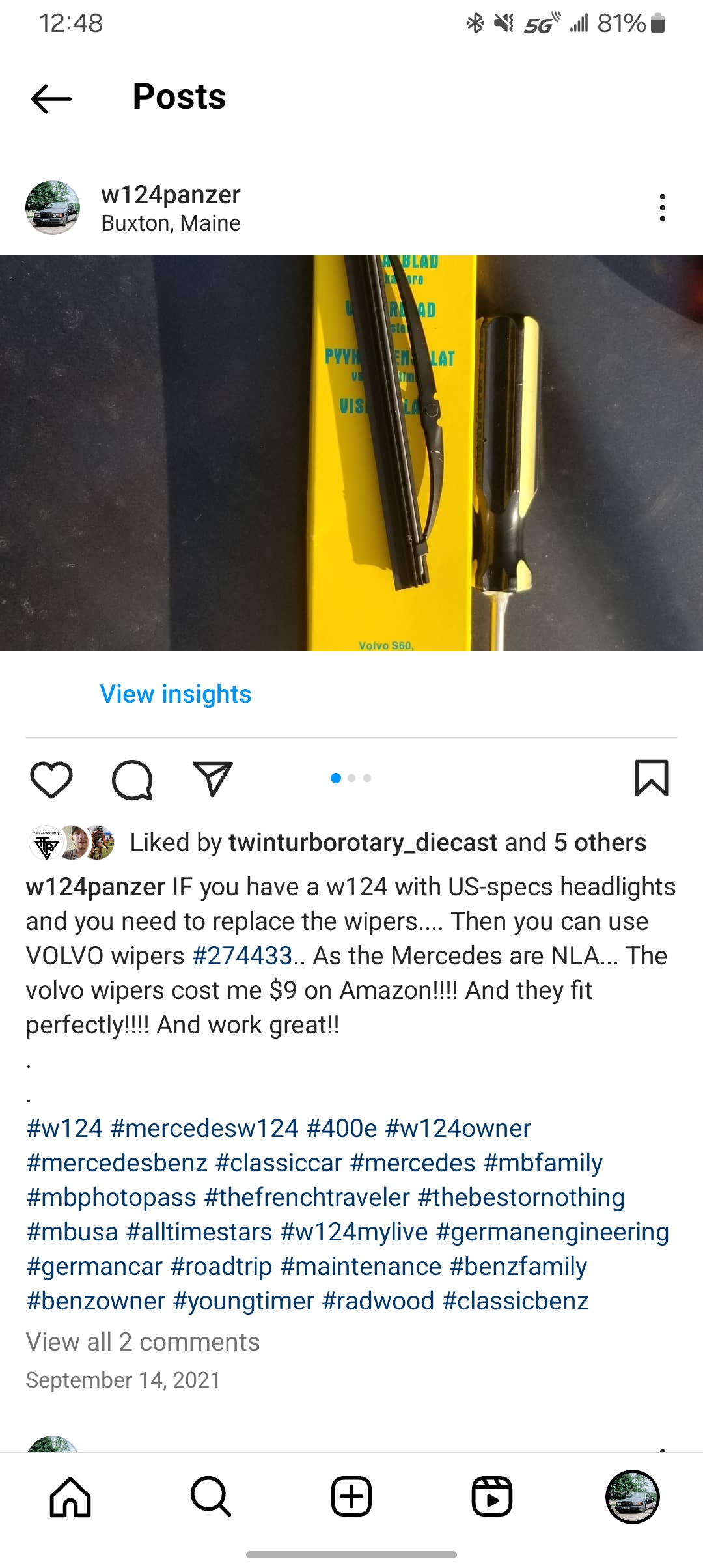

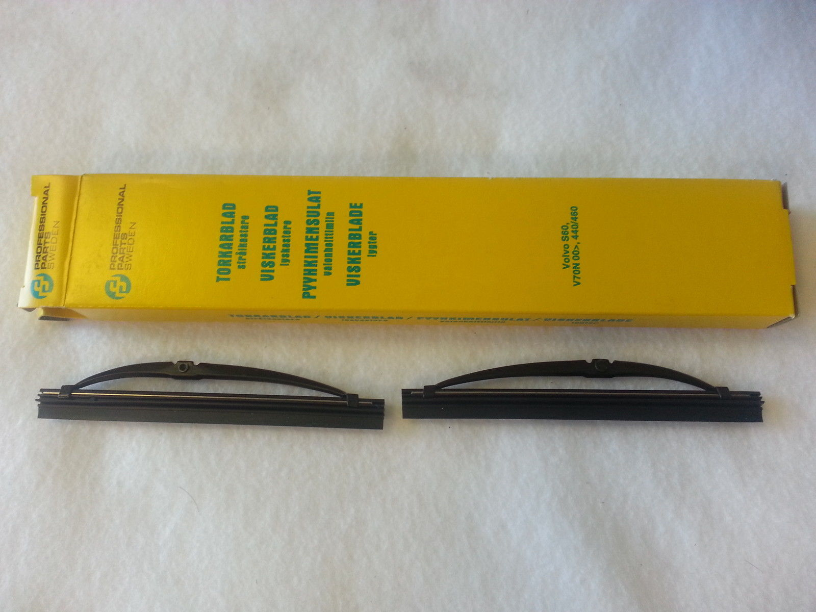

Do you just need the rubber insert refilled? The blade itself (holder+rubber) is NLA, but it's possible to refill them with fresh rubber from a new larger refill.
:sawzall:
Will give them a try!
Many thanks!
Works on a 95 E320 possibly as well?
Put the Volvos on my 93 500e and they clip in fine but are a little long and go past the crack between the lens and glass frame.
Still have to check about actual operational effectiveness and will report. Can’t cut to fit b/c the notch for the metal stabilization strips is still just beyond the separation.
If they work fine they are a very good and inexpensive and available replacement.
