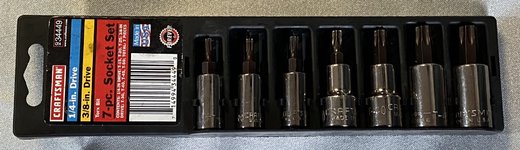

So excited this morning, time to change the combo switch and I get stuck at Gerry's step 3
3) Remove the two screws that hold the airbag to the wheel, from behind. I believe they generally use Torx bits.
Those torx bolts are at least 2 inches (52mm) deep into he back of the steering wheel. And guess what kind of torx bits I have? Big fat ones for 1/4" drive socket and they don't fit in that hole. Then I have a multi-bit tool but the extension is too fat. Then I also have a tiny bit set screwdriver but the bits are not big enough. My thing is too big to fit into the hole!!!
Time to find something at Amazon.
You will need a T-27 size for these bolts. Look on eBay for an appropriate tool (or factory tool) that will work.
I use a Craftsman T-27 screwdriver for this job, FYI. So, your local Sears/Craftsman/Ace Hardware outlet may have it in stock.
I have successfully, but inconsistently, used Allen keys in the past.
Thanks Gerry, I found a Torx bit set, including T-27, 3" (75mm) long on eBay which is perfect. You have about 6 inches (153mm) behind the steering wheel to work with steering wheel extended to max position.
Dave, the Mercedes one looks about 75mm long as well. Need a bit more than 50mm. The eBay set was only $12

Forgot to mention, a normal Torx driver will usually work if you rotate the steering wheel so the fastener being loosened is at the 6-o'clock position... and extend the telescoping steering wheel as well.
:sawzall:
Ricardo, I've done this job and was going to post a few hints but procrastinated. In my 94 E320 its a T30 for the two airbag screws. I just ran out and double checked. The T30 fits. You need to use a single Torx key without a handle. The set I have are bare metal with a 90 degree bend at one end. A driver with a handle is too fat to work in the confined space.

Thx, Peter, the set I ordered includes a T-30. I am documented this for another HOW-to to collect all the words of wisdom together for everyone else.
A Torx screwdriver will work just fine, as long as you turn the wheel to the 6PM position (and extend it out all the way). I just used it not two weekends ago on my G-wagen. I used the T-27, but I also have a T-30.
