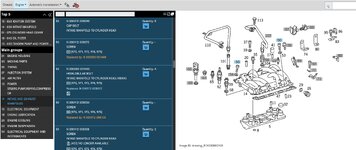

Sirry fir all questions but I am in the middle of the heads rebuilt..
There are 14 bolt hold the intake to the heads
It should be 8 short bolts, 3 medium and 3 large?
Need the bolts layout and part numbers.. couldnt find in the EPC nor the WIS

I have red this manual before and during work…
I just want to know what is the part numbers of bolts 14,15,16 in the manual…
And also their locations..
From the current factory ISPPI parts catalog.
