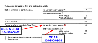

The FSM is not clear, AND has an error. You cannot use the late-style stretch bolts on early-style sprockets, the heads are larger and the bolts will not fit. I believe the early bolts are T30 or T35 (forget which). The late bolt is T40.
The early style bolt (104-990-00-22) found on CIS (119.960) and LH (119.97x) engines can be re-used.
The late style bolt (120-990-02-04) found on ME engines (119.98x) is single-use and must be replaced.
FSM link:
Screen shot with edits for clarification:
Dave, awesome... Thanks for the quick help!
It is the early style bolt with washer. So the non stretch 18Nm version (T30).
