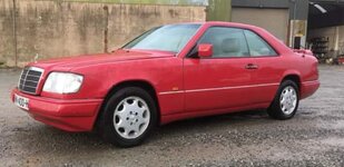

In other “developments” I guess - I did also take home another stray last night – a 220CE which appeared on facebook for sale locally. I went to look it over on Sunday and was pleasantly surprised by it’s condition overall. There is some rust to be repaired (Like they ALL have here unless pristine £££££ examples) but it is most definitely restorable. I still only have this poor picture from the vendor so bear with me on that!
It is an Imperial Red 1994 220CE Auto with cream / parchment/ :mushroom: / beige (Take your pic Gixer!) interior. It does run just fine for the most part – but some immediate items will be taken care of by me to make the car easier to move around and work on. Such as replace 3 out of 4x dud window regulators, the seatbelt butlers and some other items off hand. The rear screen is also cracked – but hey all C124’s require new screens by now due to de-lamination. The good thing is not only do I have a complete C124 parts donor (With all of the items I require) but I also have many, many C124 spares in my hoard including about a dozen seatbelt butlers and 14+ complete window regulators so it will cost me essentially nothing to pull a butt load of parts from my shelves and restore this red c124.
Only after this latest red c124 is made road legal again will I contemplate if I keep the 4 banger or do an engine swap…….
This particular C124 was from UK originally – then imported to the Isle of Man and it still holds an Isle of Man registration only. So the first step will be to try and get it registered in the UK – which should be entirely possible but may involve lots of red tape from the governing bodies. If any UK members can shed light on that I’m all ears. It’s been in the UK since approx. 2015 and never MOT’d or Taxed. Since I have a signed bill of sale dated when I bought the car those issues are (respectfully) not my problem in terms of my dealings with the DVLA! I will begin researching and completing the forms in earnest to start that process to hopefully obtain a UK V5 for this c124 which will have to be classed as an import.
I will provide better photos on the latest C124 very soon and 320CE progress will continue over the holidays
Got the first red C124 problem repaired tonight :p
The drivers window would not move and was stuck slightly down which was letting rain water inside - not good at all! It can be seen in the picture above where the original regulator was missing teeth.
I had a very nice used genuine 2006 stamped motor / reg assembly on the shelf so swapped that in and all good now - nice tight seal on the window. I cleaned off the old grease inside the window rails which looked like valve lapping paste at this stage - and may do more work inside the door whilst the trim card is off. Maybe some cavity wax sprayed inside the door and remove / grease the limit strap.
It has drivers door lock issues too. Key tumbler is jammed solid and the central locking works everywhere except the drivers door which feels stuck. I have a couple of spare c124 latch assembly's so if I can get the lock tumbler working enough for removal I'll get another good latch assembly fitted and explore stripping down of the tumbler to get it working again too with the original key.
Both doors are rust free on the red c124 too. It's very common here to see rust right along the bottom of the doors inside edge so I was glad to see this one is OK.

So here are pics of the red c124 in all it’s.... err, glory
20181226_134913.jpg 20181226_134932.jpg 20181226_134945.jpg 20181226_134958.jpg 20181226_135015.jpg
20181226_135140.jpg 20181226_135211.jpg 20181226_135205.jpg 20181226_151539.jpg
Some work needed but it’s not too bad! Interior removed for welding so I don't risk setting fire to old carpets.
What I doing for MOT is renewing all brake pipes, one fuel line, some brake work and full underbody inspection and rust repair to name a few. To that end it made more sense to drop the rear subframe out of the way and give full access to treat the surface rust and weld where required.
20181228_153844.jpg 20181228_171851.jpg 20181228_171900.jpg 20181228_171921.jpg
Overall this really isn’t bad at all – quite a solid car. 95% of the rust is only surface and has not holed or weakened the sheetmetal at all. I need to do the welding first then I will wire brush everything back and POR15 the whole lot followed by waxoyl. Really when you see the lack of factory protection to the underbody in most areas it’s lasted pretty well in our climate. Note that for much of the underbody there was only one thin coating of a primer / sealer type material. No rubberised coating or wax of any kind :doh:
