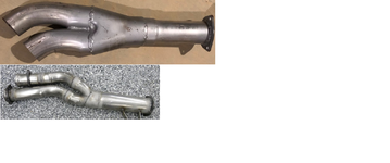

Today I figured out that 124 491 23 00 is a resonator + 2 in-flow pipes - as one piece. My usual go-to shop that said I need 124 491 23 00 to fix the leak is busy, so I took it to another shop, where guy actually showed me where the leak is (see red arrow; it's on the top of the pipe)
What I also realized is that Gerry's Y-pipe (top) is not long enough to fully replace 2 pipes that flow into the resonator, unlike Time Valve's (bottom)
Now, you can see waht my original piping looks like, and the guy from the 2nd shop says, that although Gerry's Y-pipe is just long enough to cover the hole, he won't do it because both in-flow pipes need to be replaced. He sent me off to find replacements, but, as I've just figured out, they are part of the 124 491 23 00.

Why don’t you try to find a used resonator with better pipes and flanges to weld up the Y-Pipe.
You definitely need the flange parts of the old resonator pipe. You could have new steel pipe welded in from the old flanges up to the new Y-pipe.
The right way would be to have a fabricator jig up your old resonator so that both attachment points are in the correct position and then cut or remove the parts not needed anymore and weld in the Y-Pipe.

The Y-Pipe is Timevalve. I bought the muffler on
e-Bay and it is a RENNTECH off of a SL500 or SL600.
There is no comparison to a stock system. It’s a lot louder both inside/outside the car. It sounds great outside of the car. Inside a slite droan around 35 to 40 mph. I think the packing in the RT muffler is burned out. I have been kicking around having it cut open and re-packed.

Here is the Y-pipe (not the Timevalve unit)
I've finally installed the Y-pipe. Was charged 2.5 hours of labor by local Midas to adapt it to my 400E. Barely, if any, change in noise, but there's a slight turbo hiss now.
Is this, supposedly NLA, 1 year old center muffler for 400E that was cut out for Y-pipe worth anything? Cost me $600 a year ago 🙄
