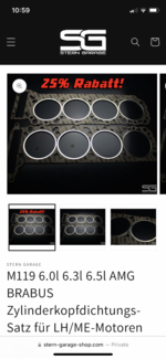

Sorry to revive an old thread but been searching for this data for a while now. Is this available anywhere?
