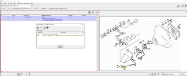

I am going to convert to complete memory package but I'm missing one part of the steering column harness.
It is item 170 in the old EPC section 46-105-7, so if someone has access to that it would be great to get the PN on it.
BTW, item 167 is #002 545 59 07

All the memory seat el.motors and the control modules are specific, while the el.motor on the steering column already has the memory function as standard for all models, the only difference is the switch and harness. The rest of the gear mechanism sitting in the seat bases are the same for both W and WO memory.
