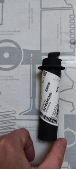

As for drain hoses - here is the best way to solve this problem

Thanks for the tip! Tube 210-830-03-96 is $11.50 list price, or about $9 from discount dealers:

That's amazing. I was looking at hoses from other MB to see (W116 actually look like they will work as well... but didn't buy them yet to test, and they still avail and not NLA surprisingly even though it's an older model MB)
So these 210- hoses will mate up, same diameter, clip on and reach thru the floor? That's cracking great news ! Much better than my aquarium hose idea.

Yes, these hoses fit without any problems.My mechanic has replaced them years ago on his 3.0-24… and it's he, who told me this stuff)
