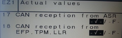

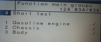

I have Star DIagnosis scanner and performed possible checks.
One fault - "switch S65 does not close"
Could you, please, look to results and tell - are any problems here ?

I wanted to know do these received values show proper engine functioning.

I would not replace S65 unless the code keeps coming back, AND you have verified the wires to S65 are all intact.
Everything else looks ok, your LH module has not yet adapted, I'm assuming you just cleared / reset it. The adaptation values should appear after you drive it a few hundred miles.
:5150:
Coil voltages look higher than you want. The are higher than mine... Chi wires,plugs caps.. then replace coils if nothing else is wrong.
Coil voltages on my cars are 30-35 depending on the car. New coils may lower that a bit. If you're not having any misfire problems, I wouldn't lose sleep over it.
