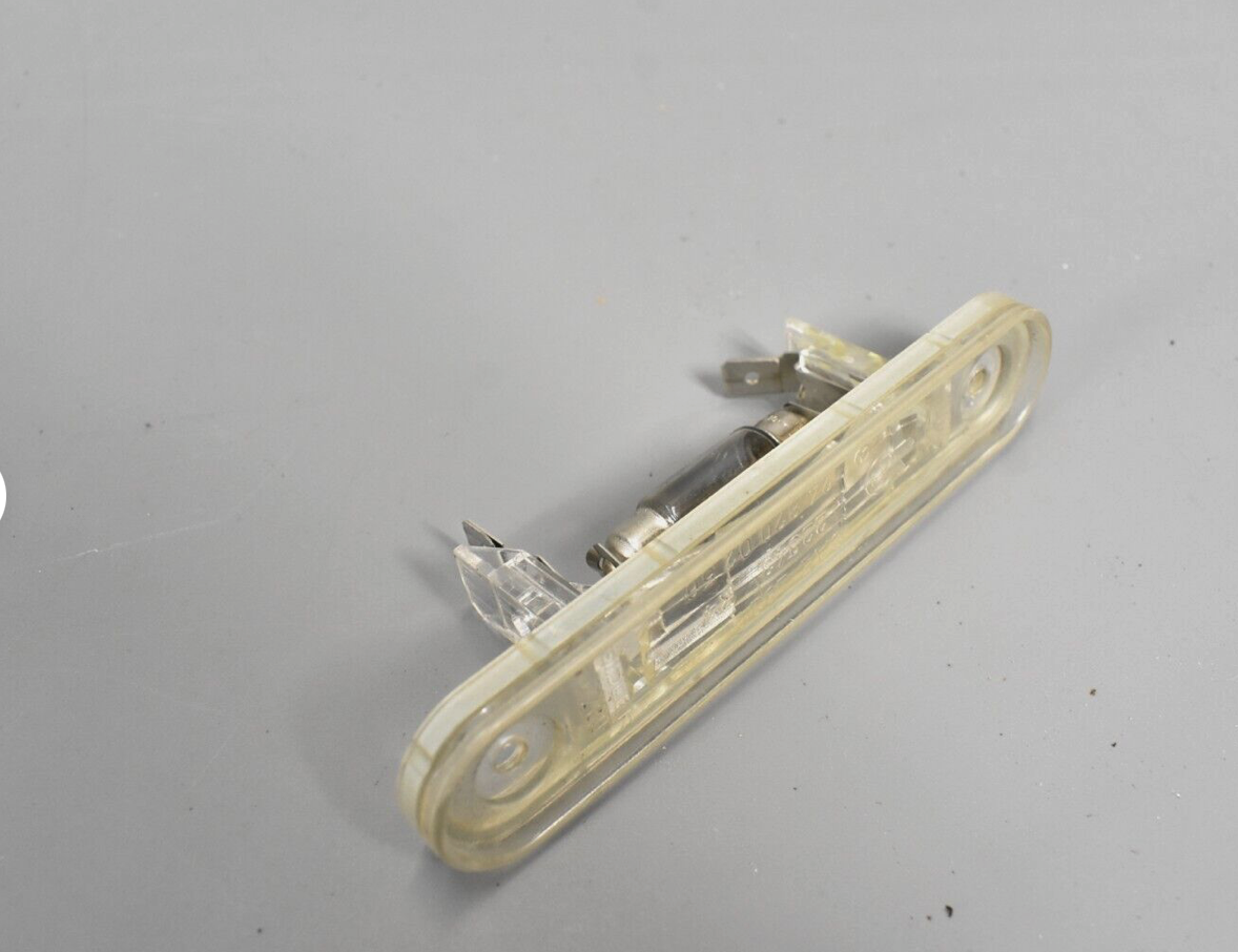

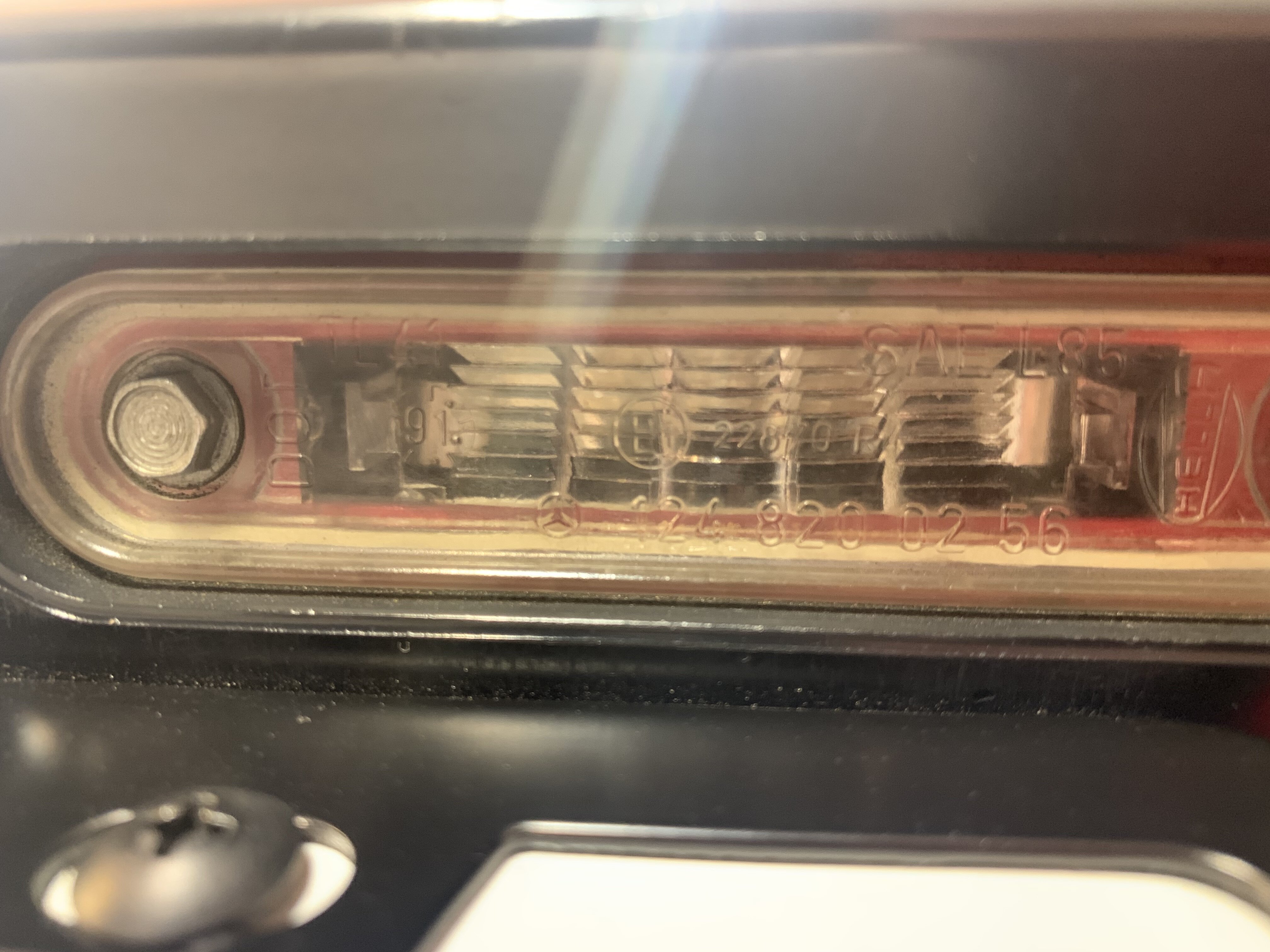

Does anyone have 124-820-02-56, perhaps in their used parts hoard collecting dust or on a junked car .... that they want to get rid of?
I'd like to give you a few clams for it if you are willing to part with it. This is what it looks like. I want to conduct an experiment and hack up one of these to add a rear backup cam.

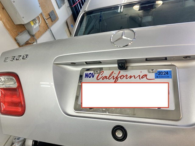

  • The "under lip" triangle form factor, which, for OEMs looks really nice and small, but the aftermarket makes 'em too ugly. See this as an example of the huge aftermarket triangle-type pimple that I installed on my w210. These typically protrude 1.25" or more below the horizontal mounting surface. This is because all of the electronics are housed below the mounting surface, and the threaded tube that projects above the mounting surface is just a channel to route the wiring.

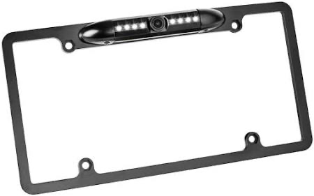

  • The license-plate frame type, which I find too aftermarket looking for my tastes:

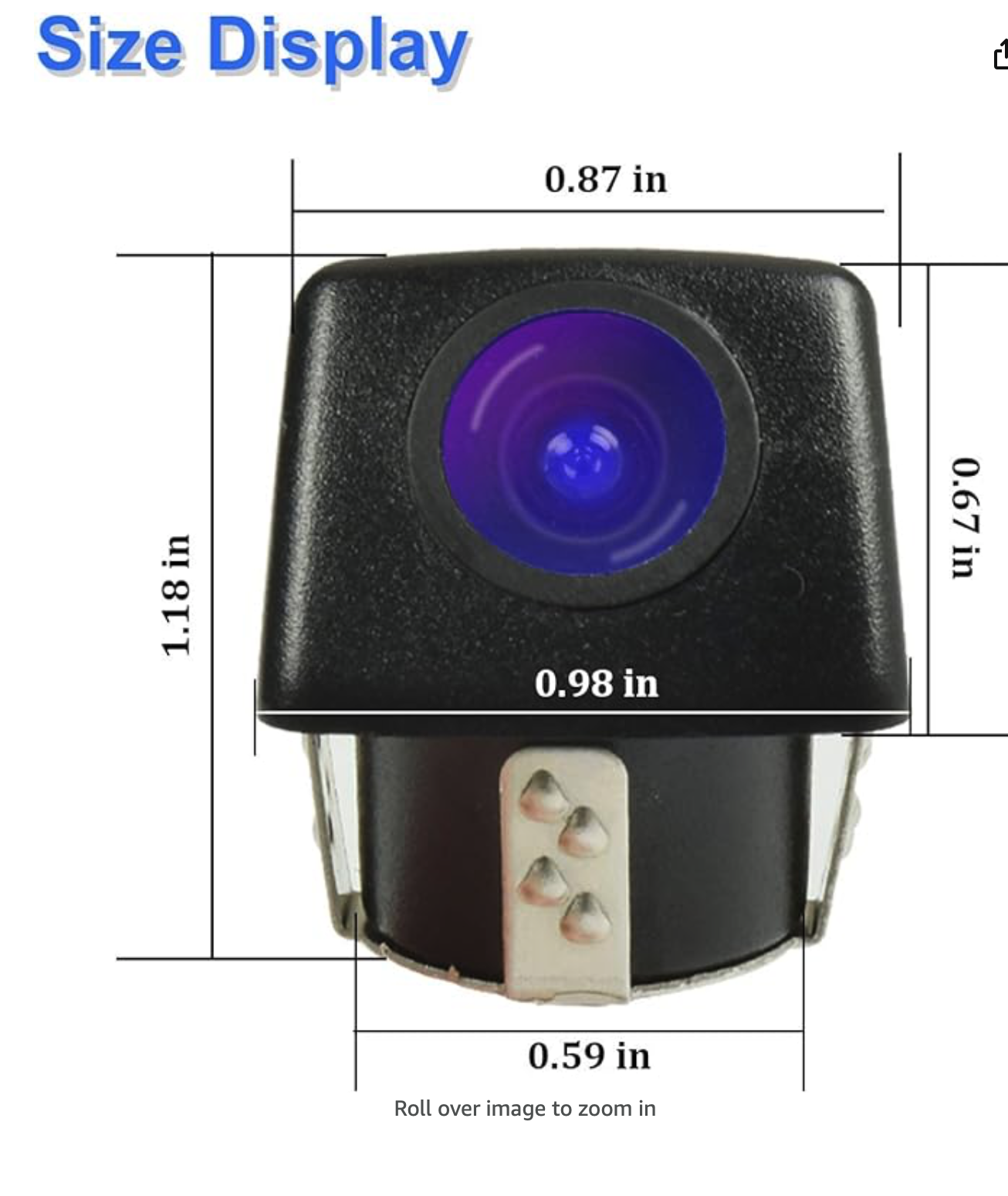

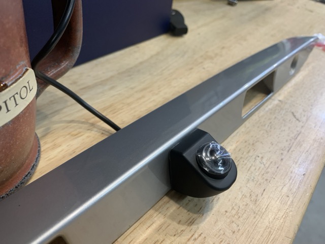

So I realized that you can now buy triangle backup cams that recess more of the electronics up above the mounting surface. This one protrudes only 2/3" below the mounting surface. However, since the part that projects up through the horizontal mounting surface is more than just a threaded tube, I need "meat" to hog out ... hence the desire to experiment with an old license plate light lens housing.
