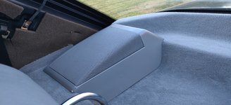

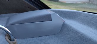

:update:
I decided to pull my C pillar trims today, just out of curiosity to see how to put the rear speaker grills back on.
I tried to remove the back seat out of the car only to discover that my rear head rests will not drop back down with the switch. I used manual vacuum and got them down and pulled the rear seat out.
After spending a few minutes staring at the rear parcel shelf, I discovered a way to put the rear grills back in place.
First you must place the rear grill tabs into their respective slots, gently push the grill rearward, pull the parcel shelf forward and upwards while gently pushing the front tabs downwards. Once they fall into place under the shelf, slide the front of the grill towards the C pillar until the lateral clip latches on to the parcel shelf.
Finally press the side with the 2 clips downwards into the parcel shelf, and if this is done properly, you will here a clicking sound.
If you did not break the cylindrical pin on the underside of the grill, you can now secure this from within the trunk with the respective clips.
It's really not difficult but does require some patience.

They look great, Seangbadee. Would you mind explaining further your refurbishing process, including the paint brand/code? I also have the gray interior. Some years back, someone claimed they could refurbish my sun yellowed speakers, but they chose a color that is way off. It looks quite obvious.
Thanks,
Jamie

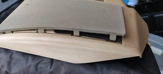

Jamie, thanks for appreciating my work. I did this 5 years ago in my 300E, and ended breaking up my grills because the plastic was brittle. A little bit of fibreglass work helped me get them.back together.
Fast forward 5 years, I decide to do this again in my E320. I got 2 cream/beige grills from a donor car,IMG_20200331_190708.jpg
and after removing the metal grills, IMG_20200331_191526__01__01.jpg I carefully roughened the surface up a bit using 120, 180 and 220 grit sandpaper. I then applied (to cover and grill) 3 coats of paint, followed by 3 coats of clearIMG_20200331_210431.jpg
The clips that have to be removed to prevent the cylindrical post from breaking off are shown below
I hope this helps.

Thanks, seangbadee. Did you find the “granite” color to be a perfect match?
Jamie
