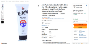

Thanks for the tips! When I did the front LCAs, I lowered the car on to some wood blocking so the weight was on the wheels, gave just enough clearance to get underneath and torque the bolts. Will do the same with the rear links. Was planning to use some liquid soap to facilitate insertion of the bushings, did the same on the LCA bushings, seemed to work well. would there be any reason to use syl glide instead of soap? I would not think soap would affect the rubber….
Sounds good! If that doesn't work, what I do is remove the rear spring by removing the inner LCA pivot bolt. After tightening all link bolts, re-install the spring and leave the pivot bolt slightly loose. Add ballast in the trunk to get the rear ride height level (approx 14.5" from wheel center to fender lip), then slide under the car and tighten the pivot bolt with an impact wrench. Now lift the car and torque to spec. Lowering the car onto blocks to get a few extra inches of space can help. It isn't fun, no matter how you do it.
For the subframe bushings, any lube that is rubber-safe will be fine. Use it sparingly! A little goes a long way. Also, the forward/smaller bushings will want to squeeze back up/out when you release the tool pressure. You may want to leave each forward bushing compressed by the tool overnight to try and keep them in place. The large/rear bushings are usually not a problem.
