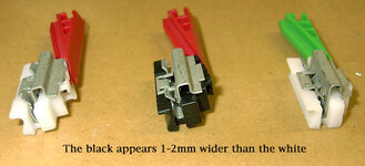

FYI... there are different clips at the rear of the roof rail (black metal clip instead of silver), and there are 3 sizes of each. I've always replaced the existing ones with the same size/color/type.
So if I want to order the correct number of clips to re+re one trim, what exactly do I order and how many?
Unfortunately, the only way to find out is to remove your roof trim rails, and look at the existing clips... then use the photos above to determine part numbers. Each car may be different.

Did you find any reason around the various clip size combos green/red/white/black?
I only have the green and the red clips. Of these, the difference is solely in the colored portion of the clip, the red being taller but no wider. When inserted in the channel the red clip was a bit high even without placement over a bump. I did find a clip in my stash, some which came from other cars, that had a black metal clip in the white portion of the arrangement. This was identical in size to the other arrangements and leads me to believe MB switched coatings although Daves pictures show an all black version. Still a bit puzzling.
