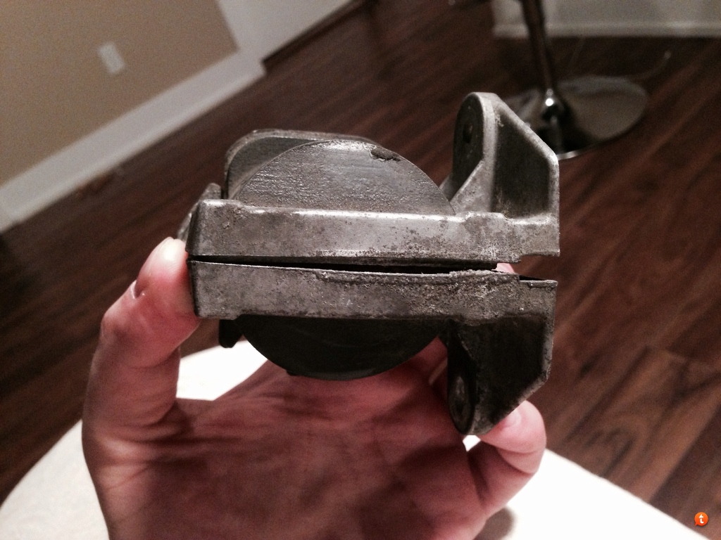

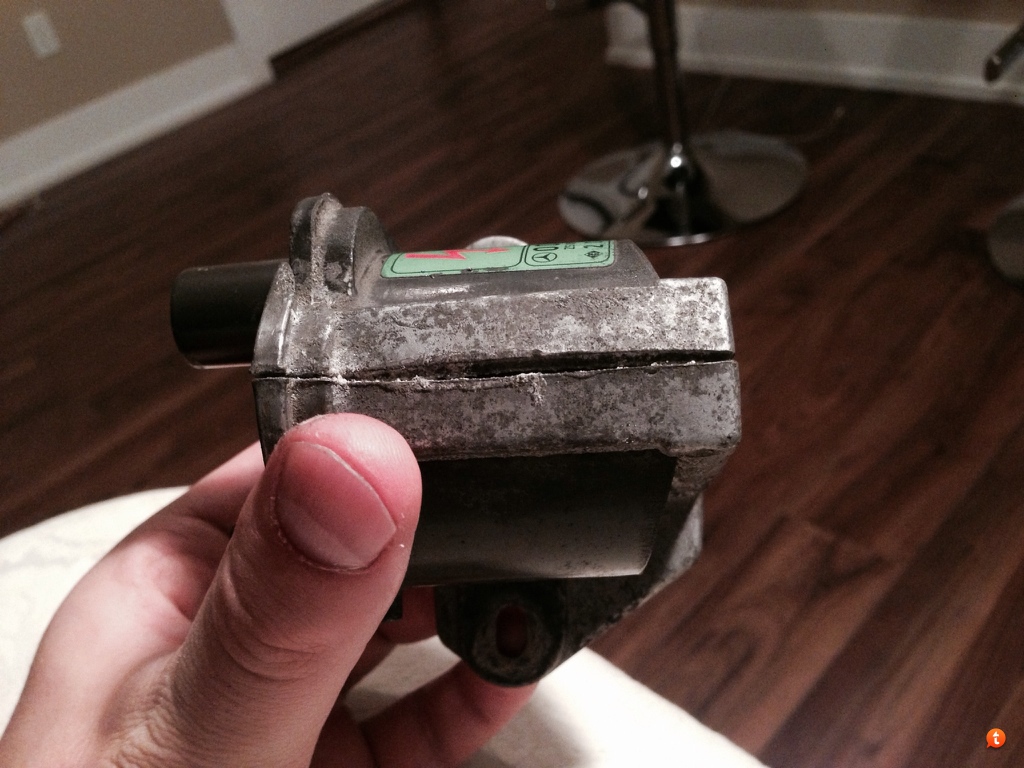

I removed one of them. It is different part number 000158 5703 and it doesn t look well - padded. By the way - i removed the headlight first... Is it the correct MB # ?
I believe that is correct. That's what came out of my 95 E420. The epc lists the Zundspule as an option. Your other coil, mounted on the side of the ABS platform towards the engine, should be 000 158 58 03.

Just a quick FYI of completely useless knowledge, but maybe other people are fascinated by this kind of thing too. The non Bob Bosch coils that are sometimes seen on these cars are made by the company May & Christie, a large German transformer company. Lots of light ballasts and the like. That's their tiny logo on the extreme lower left of those coils in the photos. BTW, "zundspule" literally means "spark spool" / spark coil. There. Now you know. How can your life ever be the same again?
