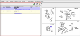

  • W140 ETS:ASR.png
    W140 ETS:ASR.png
I think your car has ASR, not ETS. The hydraulic unit under the hood is shared between ASR and ETS systems, but I suspect it should have an ASR control module in the CAN box, and should not have an "ASR" warning indicator in the instrument cluster with ETS. Also, the EPC shows the "ETS" module grayed out for the 140.04x chassis. I'm only seeing ETS as available with either diesels, or the 6-cyl cars.
The ETA is completely different between ASR and non-ASR cars. The ASR ETA has a white decal and the throttle plate will only open half way. Non-ASR ETA has a green decal and will open fully. They require different control modules also, ASR uses E-GAS, non-ASR uses T/LLR. (ETS uses yet another module.)

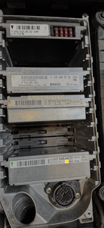

See the pictures attached. I have an ASR/PML module + ETS hydraulic block - is that the reason for the ASR indicator in the dash?
I believe ESP was not available until the facelift cars, along with the 119.98x engine and 772.6 transmission.

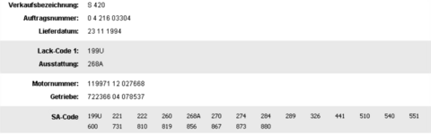

Check your datacard, look for either option code 471 (ASR), or code 212 (ETS).
I have neither.

Your car definitely has ASR, not ETS. The reason for no code 471 in the datacard is likely that when it was produced, ASR was standard equipment. All E500E's also do not show 471 in the datacard, for the same reason - it was standard, you could not order one without ASR.
So yes, you need an ETA for ASR (white label) and it must have the correct / matching connector type (likely the late-style "tubular" connector, not the big old pancake connector).
:asr:
