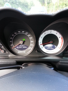

Then most importantly, it's alive! Not without a heart beat skipping moment....or two:
I bled the coolant system, filled about a liter of engine oil through the oil filter housing to get oil to the pump and the remaining quantity normally through the filler, topped up power steering and zhm fluid, hooked up the battery, unplugged the crank sensor from the ezl and crank it up to built up oil pressure first.
I fixed my view on "the right gauge" and got nervous after the needle didn't move up after 5 seconds. Stopped, again, this time cranking maybe 10 seconds - still needle not moving up.
God damned I started sweating. Quickly re-asessing in my mind if I had plugged in the lower wiring connector responsible for the gauges, yes I did, and the sensors, yes sure - I triple checked that.
Looking again at the instrument and noticed I was looking at the coolant temperature gauge.... I was so fixated on the movement of the needle that I did not notice the scale behind.... Again cranked it over and surely, oil pressure was there almost immediately.
Plugged back in the crank sensor plug into the ezl and the engine fired up right away!
What a feeling!!!
Then also I noticed that the lights in the cluster didn't turned off, again, ha di connected terminal 61 on the alternator and on the connector block, yes I did - just increased revs a bit and lights went off but came on again when resting in idle speed.. So maybe the new 150A alternator isn't that good? Need to check that.
I let her sit idling until the radiator got hot and then switched her off and called it a day as it was 1am again.
Tomorrow I will keep her running for a little longer to get the valve lifters also proper bled as they are ticking slightly still... But as they were sitting for a couple years they are surely quite empty.
Also I noticed that the engine runs a bit rougher than a 5L as well has a slightly different sound. The liter displacement difference shows here I guess....

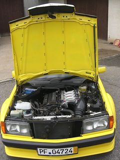

Some updates here...some might remember my slide throttle evo1.
Since many years I wanted to built a real sport engine for it and keep the original engine (it was mechanically never modified or opened) aside.
The slide throttle system was installed on the stock engine in 2009 till I took the decision already like I believe 6-7 years ago to sell the slide throttle, convert the stock engine back to CIS-E and start to put the plan into realization.
Slowly the engine built project was initiated. I bought parts over a range of about 16 years which all major basic compinents were together back then.
All started with a standard 2.5-16 Block (repeatability in case of engine failure) bored out to evo bore size, further modified with ventilation windows in the crank mounting gallery, oil squirters etc.
A fine ballanced evo2 crank.
Evo1 full CNC cylinder head with dtm sized valves
DTM amg intake cam adjuster of 1992
DTM cylinder 1 recognition device on the exhaust cam
Speacial made pistons and connecting rods by IRP
And some very unique items of Mercedes-Benz Sport-Technik. Now, one has to know Sport-Technik was the own, internal racing division of Mercedes-Benz which also delivered the power trains for the famous le mans winning c9 and following group c cars. Both were untill end of season '90 strong competitors to AMG. ST teams were Maas Schons (MS) racing and Snobeck for example. Sport-Technik was dissolved and partially merged with amg in end of 1990 and since then Amg got the stripes on their which originated from Sport-Technik (remember the sportline logo? That's Sport-Technik!
Now back to the project... I got some über rare parts such as an NOS Sport-Technik magnesium oil pan and the ST (in short) magnesium roller barrel throttle system, much rarer than the already rare original slide throttle dtm parts which now finally found a purpose.
Now the parts are merged in a evo1/2 st/amg chimera.
Project details were in various occasions, like cam selection, cam adjuster travel setup etc. done in alignment with a man which was and still is highly involved in such projects even so he is meanwhile retired but was working during his active time first for ST and later for amg.
Recently the engine is in the last phase of it's build, with readily adjusted timing, tested oil circuit and cam adjustment function only final assembly of components such as accessory belt drive etc. are yet to be done.
Plan is to get it in feb/march into the car with a new transmission (keeping all original components aside) and a evo2 ratio 3.46 or possibly 3.67 ratio diff - so maybe it is ready to run in summer 2025.
