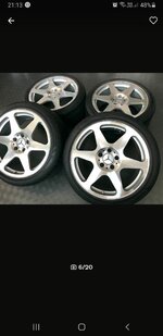

Some update here, got recently a set of Neez Euro 6 wheels and might put up even the Rials on sale, but haven't decided yet. Fact is that i want to reduce my footprint as well to reshape it even a bit. Where we currently plan a professional photo session for the Evo2 to put it up on sale (potentially).
Maybe the R129 will also go in the mid-term.
Not for the need of money just to reduce the number of cars.
On the other hand I have shifted my professional focus as I have decided to end after 27 years my career with Mercedes-Benz last week and moved on to become the aftersales manager of the local Porsche dealership. Part of my motivation was due to current MB strategy which I don't believe in as well the luxury approach where I don't see the quality either and luxury isn't because you say it 100 times or put stars everywhere.
As a compensation for the evo2 I m going to try to get something new (would be my first newly ordered car), sporty & wingless made in Zuffenhausen 🤞🤞🤞let's see how that goes - unless something changes my mind to keep the Evo2.
Here some photos of the Neez, clean set.
