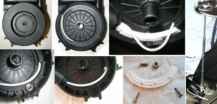

Here is some pics of my fix of the frozen mast on a Hirschmann #B6682 8099. I don't have pics of the entire disassembly, but the antenna has to be taken apart to free up that toothed nylon feeding wire from the el.motor. Next the mast was soaked with WD40 or similar juice and left for a day or two. Then I start working the mast up and down until it loosened up, which can take some time, followed by a thorough cleaning with solvent to remove the WD40. The mast has to be completely dry with no lube, those cleaning tissues contains the needed and correct lube if any.

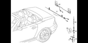

I have a "SLK" antenna from the R170 installed on my car. It a so called bumper antenna with amplifier and sits as said in the rear bumper. It's like a 2 wire loom.
Does its job very well... No antenna anymore on the fender.
Wouldn't do that anymore nowadays but we all have been young right... Done that mod 22 years ago jeez tucking fime flies.
Number 11, plus a specific amplifier the antenna plugs in and the radio antenna cable screws onto it too
