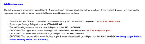

I paid somewhere around $2k+ on eBay UK for one new shock and around $400 for the last new one found at an online parts dealer.
Lot of cash for two worn bushings.
Given the burn rate associated with these cars I guess it was a bargain. 🥴

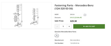

someone told me r129 sl600 rear shocks would work on the e500 , any thoughts or just stay away ?
Great question. I am not sure. The R129 rear SLS shock looks similar to the E500E units. You'd need to buy them and verify the overall length/travel is the same. If so, it may be worth a gamble to try them. The internal valving is almost certainly different, but may be close enough to not cause problems with the E500E. There are different part numbers for early (93-95) and late (96-up) SL600, I don't know the difference. 1293200113 early, 1293201513 late.
I can't recall if this was previously discussed on the forum or not. :scratchchin:
:apl:
if the SL shocks would work on the 500E that would be great because it looks like they are still available from Mercedes and the price is pretty affordable
