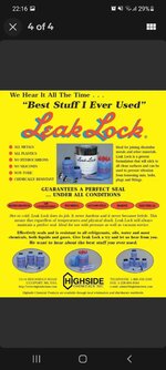

Might want to use Nylog Blue on some of the fittings as well, although I'm not sure if it should be used on O-rings or not, there seems to be conflicting info. Maybe @M104-AMG can chime in:
Couldn't source that sealant Dave but located a USA branded one here which appears suitable for refrigerant so hopefully same thing:
Screenshot_20210728-221654_eBay.jpgScreenshot_20210728-221651_eBay.jpgScreenshot_20210728-221649_eBay.jpg
Intend to apply this sparingly alongside new O rings unless advised otherwise by members.
