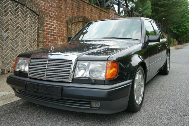

Hello, I just swapped my headlights to the EURO Spec and I am now on the hunt for a pair of blade arms and blades. Thanks in advance.
I need these.

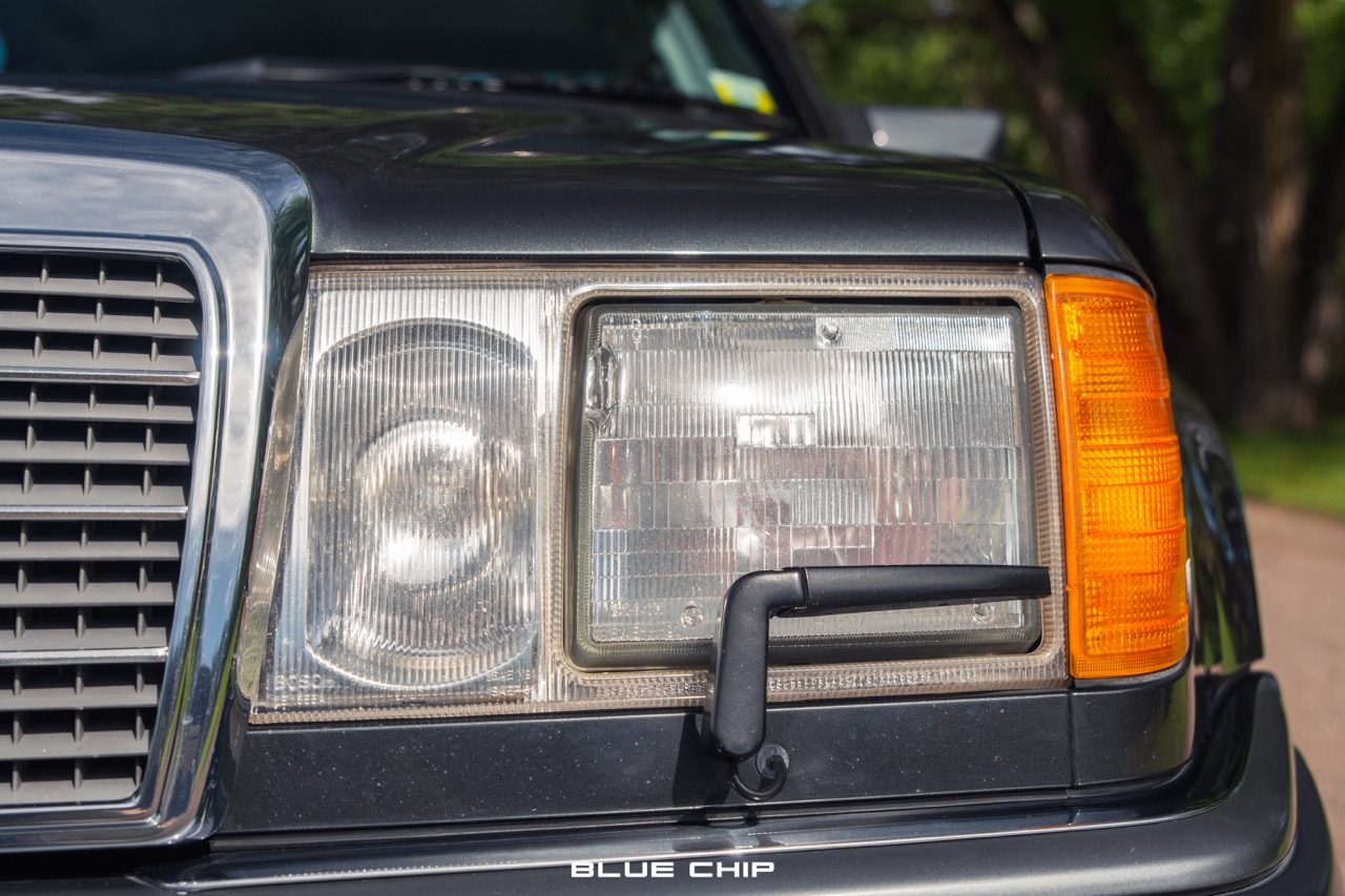

I have these

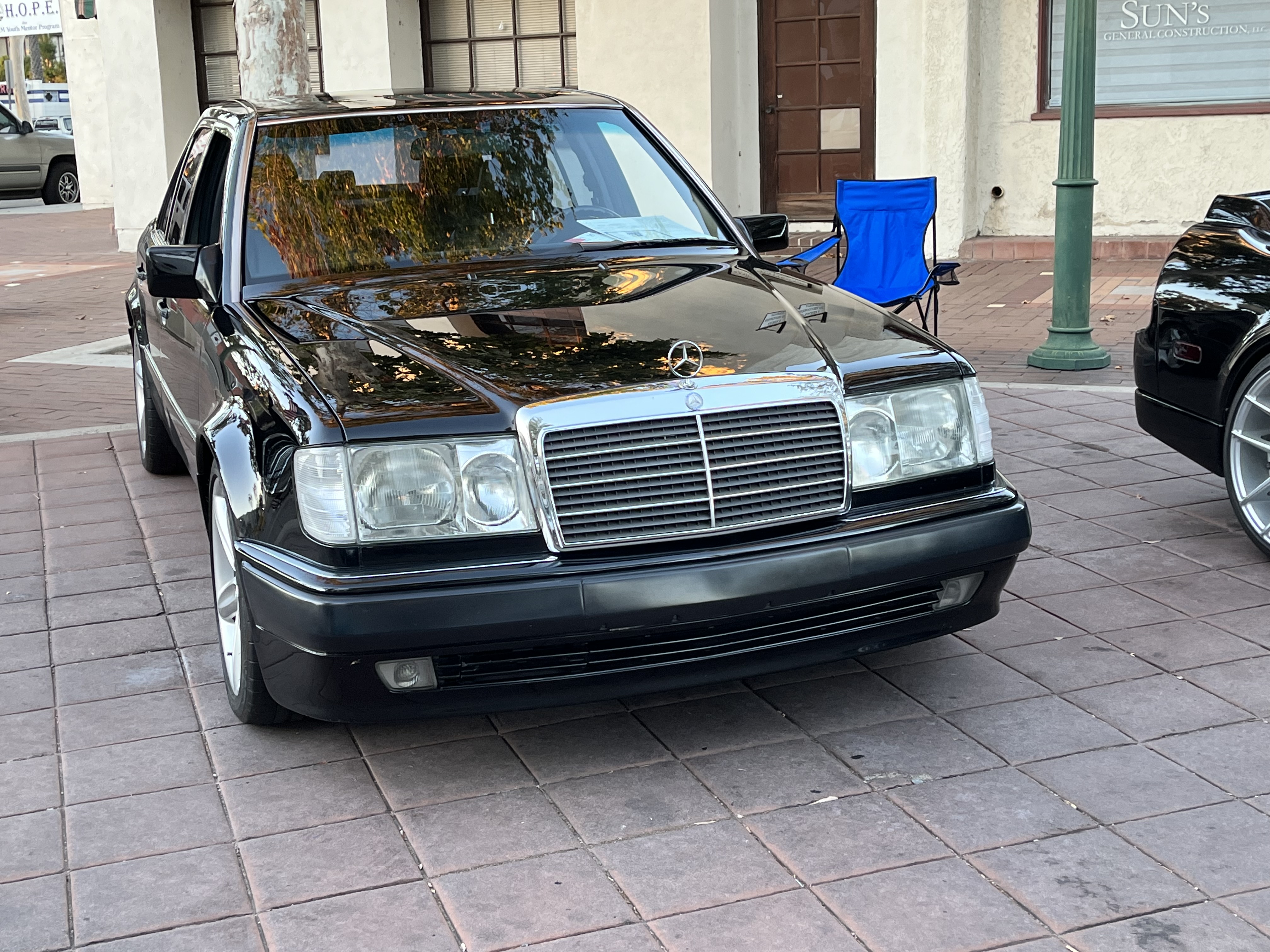

Never understood the need to have the wiper blades for headlights, unless you are driving through deep mud or deep snow. Threw my away once I got the euro headlights. One less thing to fix and I prefer a cleaner look on the headlights without those blades.
+1 w/ Steve! I have no use for the headlight wipers either. I removed when I installed the Euro E-Code headlights along with new wiper delete panels below them. INOP a much cleaner look.
Plus it hardly ever rains in SoCal anyway and when it does my car stays in the garage. :jono:

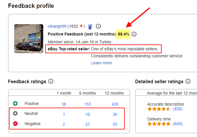

FYI, those Turkey arms/blades are aftermarket reproductions, but should fit ok for cosmetic use (the wipers are really only needed when driving in a bad snowstorm, which is unlikely in the Bay area). The repops likely do not include the 'squirter' piece which is separate, and snaps into the back of the arm on OE wiper arms.
Keep in mind these Euro wiper arms also need the "Euro" motors to be functional, and also need different trim panels as well... search the forum for details.

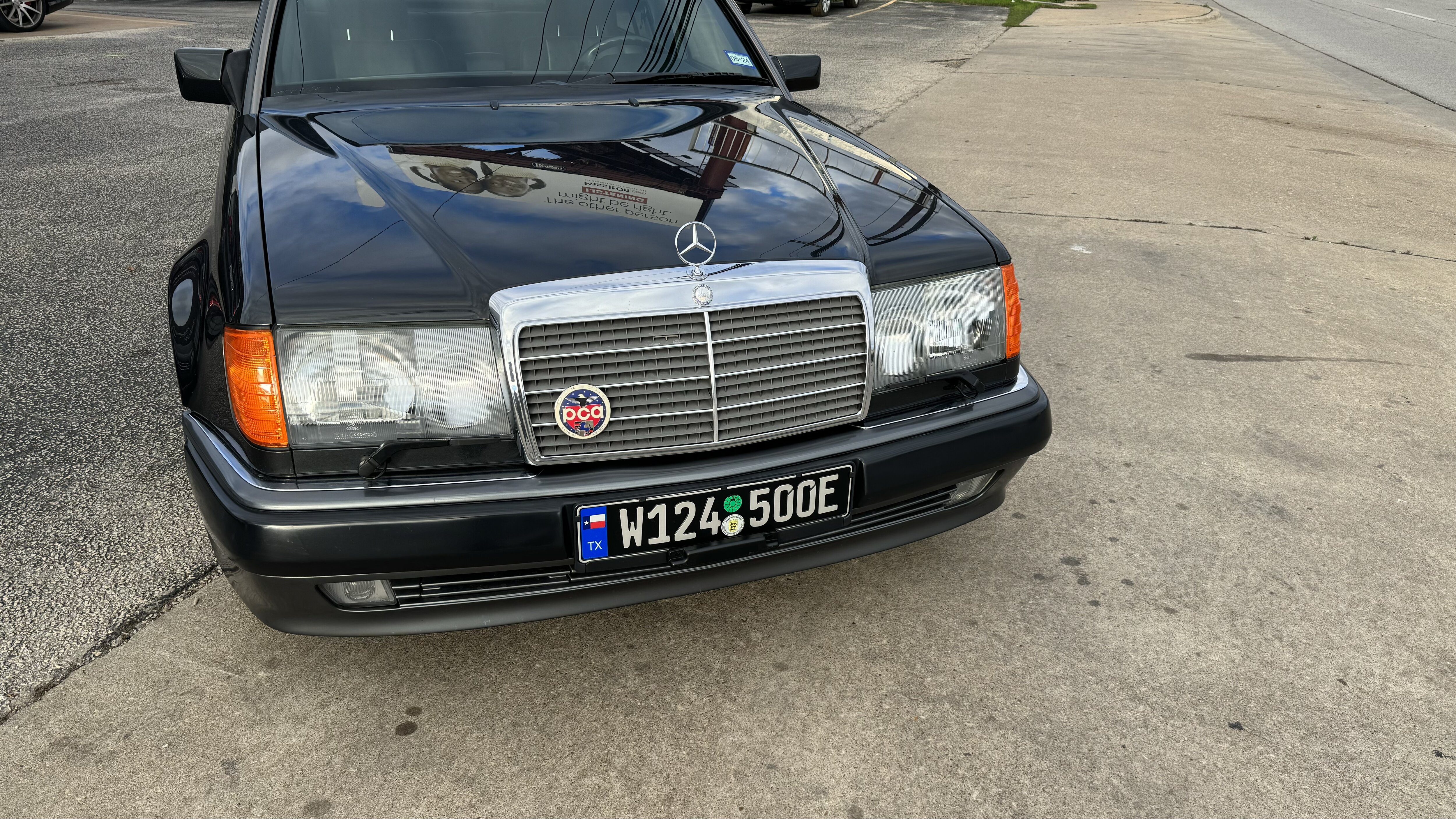

Some learnings, for a 93 and earlier, you don't need new motors there is a switch inside the motor to let them know it is not US, I did find the new panels and had them painted, and was able to locate the wiper blades and arms, everything is working perfectly. Looks and feels as it should! - thanks for all the help!
here you go!
This is not accurate. There is no "switch" inside. There is a plastic section which keys the motor frame to the headlight, and the USA motors can be switched left to right to physically bolt up to Euro light assemblies, but the sweep will not be correct - only part of the lens will be cleaned when they operate, if they are functional at all. The wiring is also different left to right, so to function I think rewiring would also be needed. I've never attempted this so I'm not sure of the caveats.
Glad you were able to get the full setup installed, it looks sharp! I assume you are aware that you lost the auxiliary high beam function since those are standard 124 Euro lights, not the 500E-specific units (which have been NLA for years). Not a big deal if you don't use high beams much.
