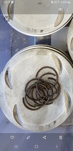

You need to inquire with them.... Important as said to share the exact (measured) cylinder diameter - not what is written in the book.
If you see from factory there are tolerance steps which are not communicated in the regular documentation as well as this applies for any reconditioning.

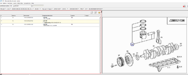

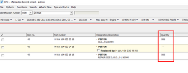

I assume if this is purchased from Mercedes its a set of 6 pistons as part of a set?
The piston/ring assemblies are sold individually. Note the EPC quantity required is 6.
Doesn't matter though... they are NLA.
