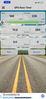

This is not my first fast car, so I have some doubts about whether it is the 5 liter version, as it is extremely fast considering the supposed engine power and age of the car. The engine does not indicate that it is a 6-liter version, but the performance I measured on GPS in conditions far from optimal is 0-100 - 5.7s and 0-180 - 16.2s. I think you can reach 5.3-5.2 up to 100 km/h without any major problems.
0-180kph (112mph) in 16.2 seconds is about right for an E50 making ~345hp.
The E60 should be about 14 seconds from 0-180kph, maybe quicker.
0-100kph testing isn't particularly useful as you often have wheelspin on public roads and ESP engages. Testing to higher speeds generally provides better data, so it was helpful that you tested to 180kph also.

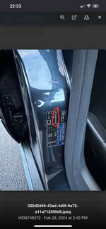

An additional thing that I have not encountered in any Mercedes - on the rating sticker, in place of the color code, there is an entry: MY1.
I don't think there's always a color code there. Mine is empty. I came across one E50 with a bunch of characters I couldn't make sense of.

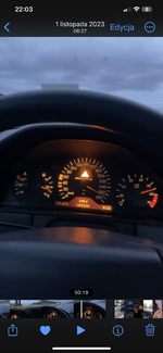

I have some photos by high speed on 4th and 5th gear. Interesting is that the difference by GPS and tacho in speed by 264km/h on tacho is 259km/h by gps
4th gear is ending by 265/270 and have 6400 rpm by 255km/h
5th gear is 5100 by 240, 5400 by 260, 5500 by 270, when i drive 270 and close the accelerator the car reduced gear to 4th…

Thx for this photo… Now i have mindf***
Number which i have marked in red is TVV number - type of vehicle. CoC tell that is:
  1. Type, Variant, Version: Specifies the model and its variations. Overall, the States TVV is a useful tool for identifying and classifying vehicles based on their characteristics and specifications, and it plays an important role in ensuring compliance with regulatory standards and facilitating the exchange of information about specific vehicles.
On blue i have marked homologation number CE - CE marking indicates that a product has been assessed by the manufacturer and deemed to meet EU safety, health and environmental protection requirements.
And now… That can be more complicated than i think. When TVV is MY1 that is proof that is like another car, CE is also another in my e50 and this from picture, that confirm that the car have another engine in 100%. This is from E50 or E60?
This is from an E50 that I came across. I'm not familiar with TVV or what MY1 means/stands for. Even if this supports the claim leading to the possibility that this might be a 6.0L such as this MY1 indication you mentioned to confirm a replacement engine, the compression ratio or a possible block stamp to indicate a closed-deck block, it's better to jump directly to a method that will be conclusive.

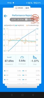

Markus-MD i don’t look for speedometer, i proof times with GPS not speedometer ;)
Brabus e650 - 450 ps / 444hp
0-100 - 5,2
100-180 - 9,3
80-140 - 5,2
Carlson c62t (e420t mod) - 425ps/ 419hp
0-100 - 5,6
100-180 - 10,6
80-140 - 5,8
E50
0-100 - 5,7
100-180 - 10,9
80-140 - 5,9
E50 french test
0-100 - 5,9
100-180 - 11,1
80-140 - 6,0
60-120 - 4,9
60-100 - 2,8
160000 km 27y old my star:
0-100 : 5,7
100-180 : 10,5
80-140: 5,4
60-120: 4,7
60-100 : 2,7
And my times can be better but i must have a optimal road conditions. In my opinion it is not normal that car is faster than when tested by professional car magazines. In monday maybe i can check this what have gsxr tell me. Best Regards !:)

And i have made more acceleration test:IMG_7022.jpegIMG_6989.jpeg

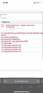

I have bought the valve cover gaskets for my MB in mercedes dealer, when i give the guy the number of gasket they say me that system said this gaskets is not for my car (1190160821) and for me something interesting was that the valve cover on passanger side is made by amg, and on driver side was normal mercedes cover. It is normal ?;)
Valve cover gasket kits are part numbers 119-010-23-30 and 119-010-24-30 for your M119.98x engine with ME 1.0 injection.
Part # 1190160821 doesn't exist in the EPC, but appears to supercede to 119-010-14-30 which is for older M119.97x engines. If your parts guy said this is not correct for your car, he is right... you need #23 and #24 gaskets noted above.
