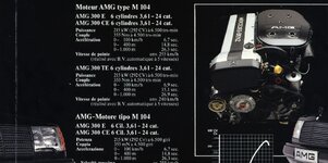

Hi all,
I'm dealing with someone long distance. They claim they have a Head, from a 3.2 litre Japanese AMG Engine. For clarity, this is the early M104, with CIS injection and a distributor. As yet, they have not provided any castings, serial numbers etc.
I know of the 3.4 and 3.6, but cannot find anything on a 3.2 of this era.
I have a spare 3.0 engine I'm thinking of rebuilding (for my 92 300CE), wondering if this would provide anything extra over stock.
He's not giving it away though.
Anyone ever heard of this?
The CIS M104 built by AMG was 3.4l. Never seen a 3.2l version, only the M103 built by AMG was 3.2l. There were no 3.6l AMG version of the M104 in CIS FWIW.
Thanks.
I did hear of a 3.2 amg, possibly, in another conversation. It's kinda vague though. If it exists, there was about a 20hp difference from the stock 3.0, which I expect would be from displacement rather than magic in the cylinder head alone.
So, all that said, I would probably get more bang for the buck simply tweaking the stock engine, if I rebuild it.
The guy with the head, wants $1000 for it, no proof of AMG, and unknown condition.
Just for interest. The owner supplied me the VIN of the car he says the head came from. (I don't have any head numbers etc yet). One (and only one) VIN Decoder suggests it could have been a 3.4.
That said, it's still too big a gamble for $1000. My guess is the extra power of the 3.4 was mostly from the extra displacement.
