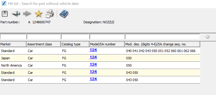

Thanks Dave! Where there differences between the Coupe/Cabrio and the Limousine? In other words would 124-860-07-47 also work for our cars?
Good question! AFAICT the V124 (limo) uses the same squirters as saloon/estate.
However, the A124/C124 had unique part numbers - but I don't know the difference vs the saloon/estate/limo squirters:

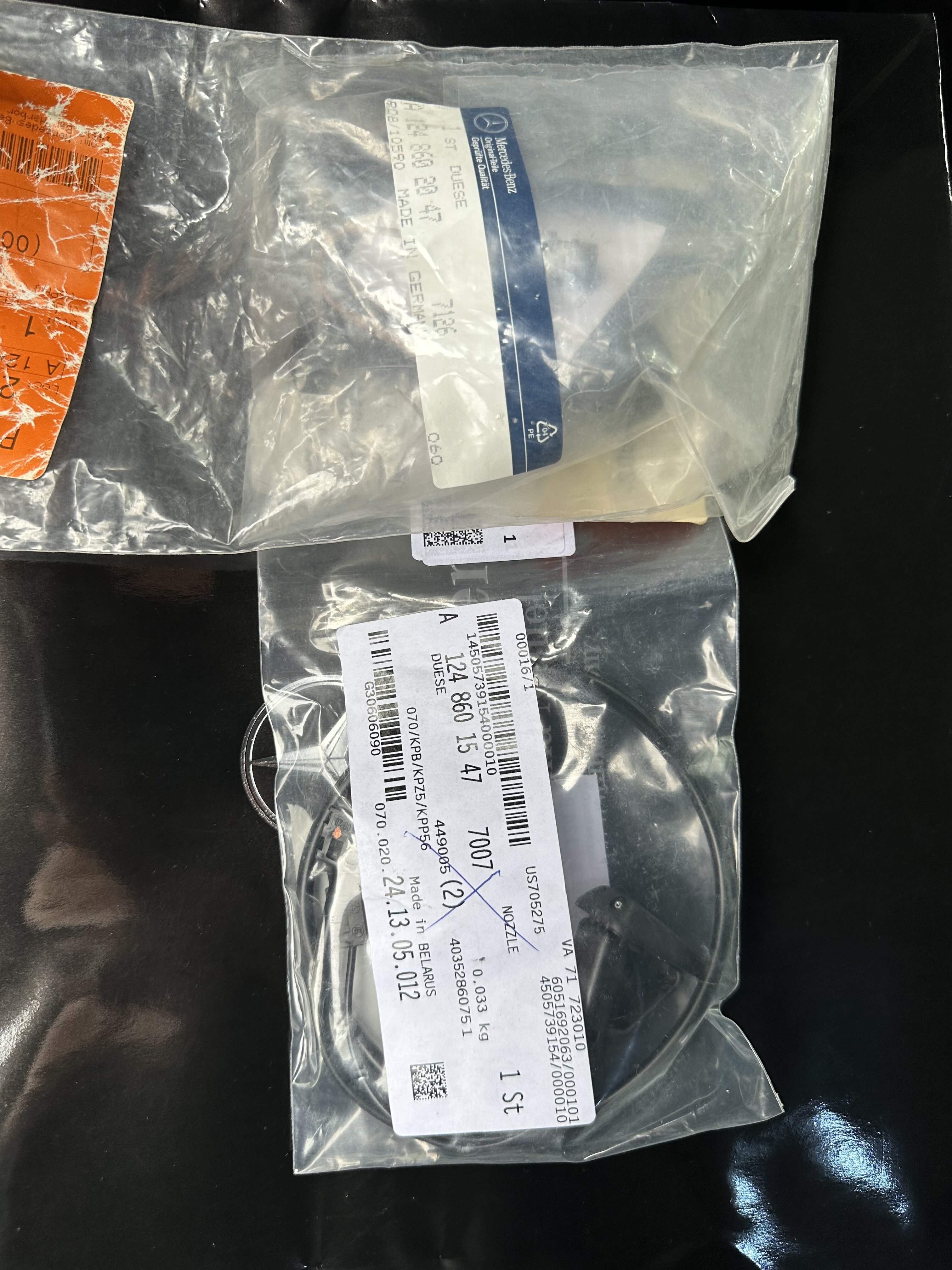

Folks, My washer nozzles arrived today. That's 4 days from Germany...pretty darn quick I'd say. Color code on the parts label for both R & L is 7007 which indicates black. However both nozzles are definitely not black but dark gray! Go figure. Good for me cause my car is color 199.
I replaced the broken one tonight and will do the other side over the weekend so I have a matching set. 30 minute job. FYI the washer hose clamp is that special type that requires a unique tool to remove. Not in my tool box so I simply cut it off and used a similar size traditional clamp.
Dealer price for the left nozzle is $92, right side priced at $84. I paid $115 for both with my employee discount.
COO is Belarus.

Any MB dealer can order them for you. Also there are several on line parts stores selling factory parts. Be aware the nozzle has a black and gray color code. Only 7007 is available which is black but I received one of each color. Not a big deal to me but if you’re very finicky you won’t be happy.

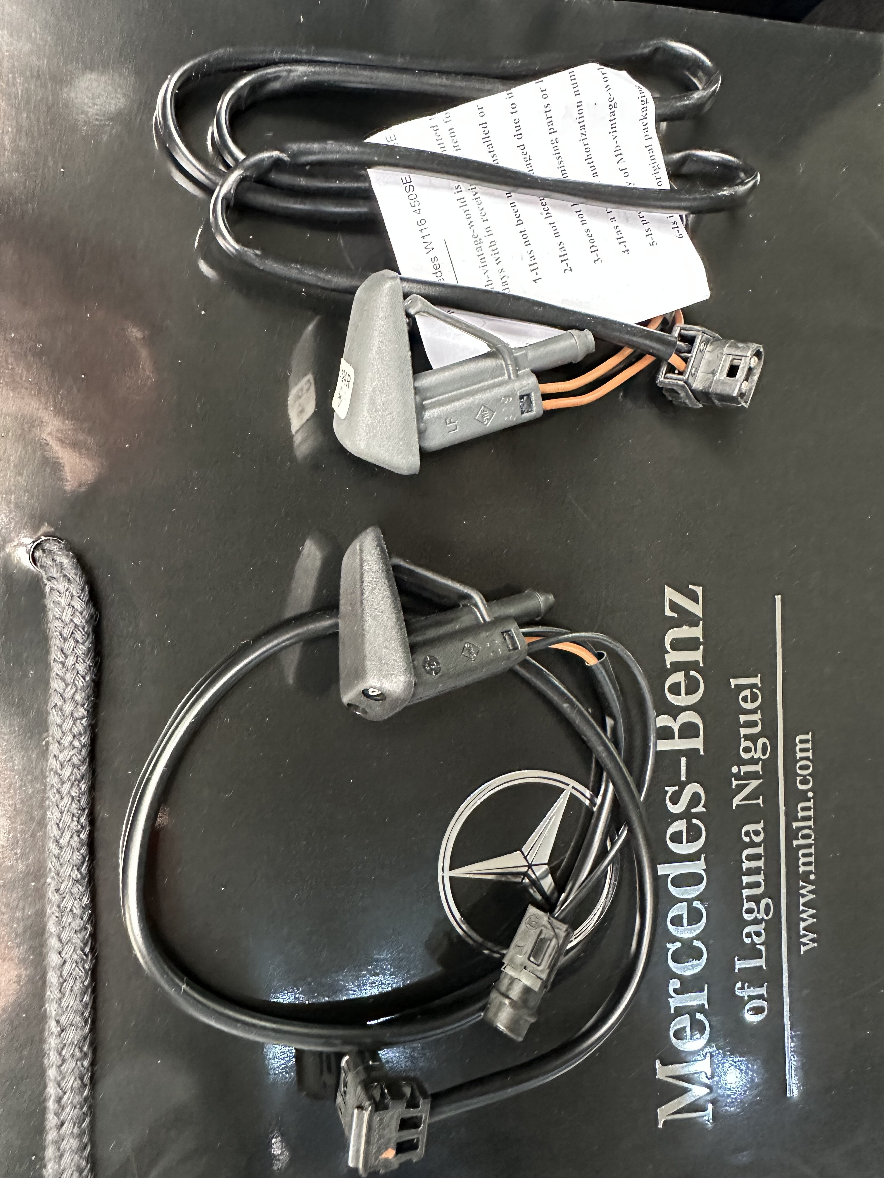

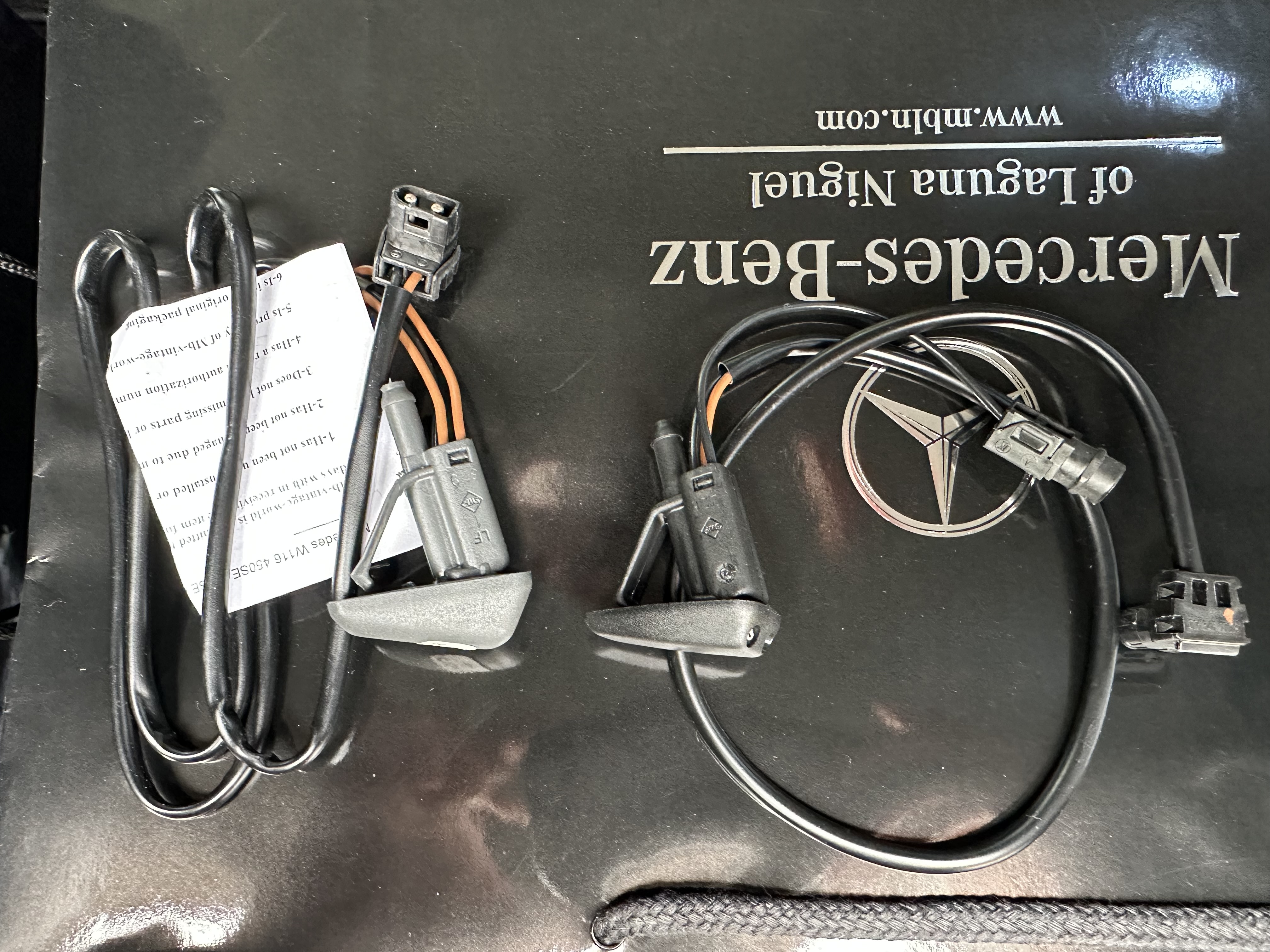

Here’s the difference :
The left image ( gray ) old part #
The right part of image is (black) new 7007 part # that I just picked up from local Mercedes parts dept.
Cheers 🤙🏼

I'm sure you know this, but to clarify:
124-860-20-47 (right), gray color in photo below, is for coupés / cabrios (#19 is left side)
124-860-15-47 (left), black color in photo below, is for sedans / wagons (#16 is right side)
That is why the profile is different.
