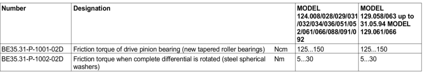

What I was able to find in wis specifically for the reinforced 210mm version is the tightening torque of the pinion nut, interesting thing is that the value is very specific and not a minimum one as the other versions:
What i could not find is specific info on the frictional torque, seems to be shared with the smaller case versions:
Found the specific values for the reinforced diff:
