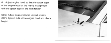

FSM 88-302 pics below (thanks @gsxr) for reference:

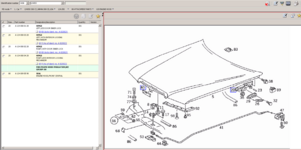

FYI gang --- I sourced a new driver's side hood hinge just in case. Actually, the E500E and w124.034 part, which is 124-880-03-28, is no longer available. Instead, I got 124-880-01-28, which is the NON-locking driver's side hinge for older w124s up to chassis 820021. You can see how the metal tab is shaped differently on 124-880-01-28 so that it doesn't lock (it shaped similar to the passenger's side hinge on the E500E which doesn't lock).
