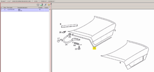

New trunk gasket:
Which is super 💰💰💰btw.
Anyways I looked up pricing on this thing and its like almost $300 shipped to me!!!!! YOWZA!!!
Has anyone used an aftermarket seal with success? Those are much more reasonable in price....
