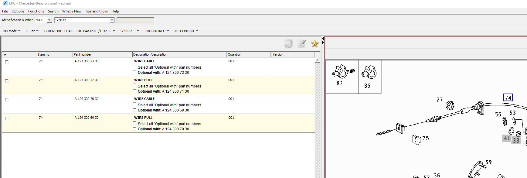

Looking for a throttle cable for my '94 E320. Anyone have a decent one available? Mine is so rusted, the bottom (closest to the linkage) has collapsed.
Fingers crossed.....
Part number linked above is for a 1994 E320 with M104.992...
:blink:
EDIT: Screenshot updated with highlight for correct part numbers.

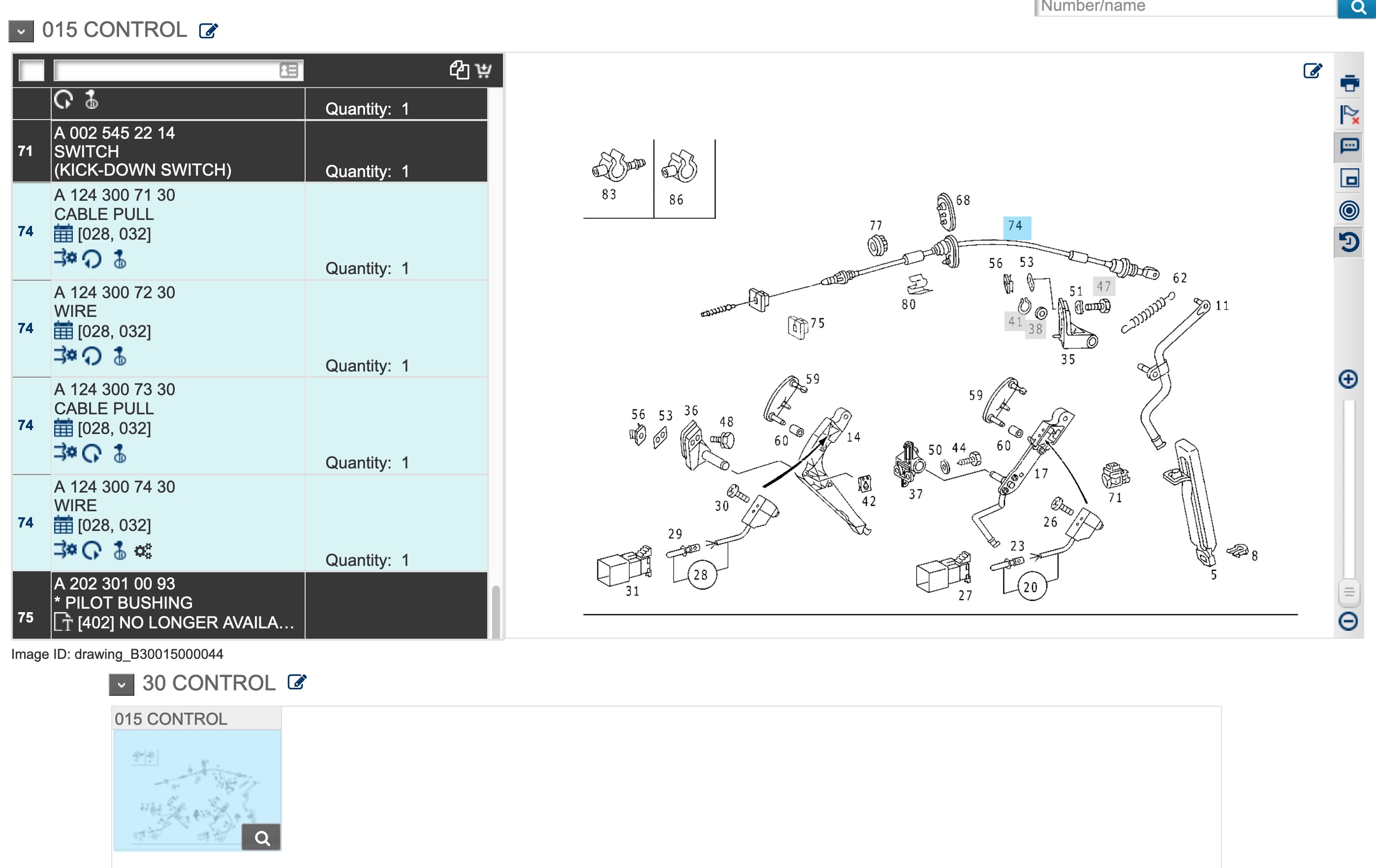

:jelmerian: -- ?
The current ISPPI system from MB mirrors @gsxr's older EPC.
The two part numbers (interchangeable) are: 124 300 71 30 or 124 300 72 30, for left-hand drive cars.
The other part numbers (124 300 73 30, 124 300 74 30) are for right-hand-drive cars and thus not applicable to US models.
:gsxrepc:
No Gerry. ☹️ I totally forgot the code. And I've read about it several times. But I did use mboemparts. Cost me a little extra then...
