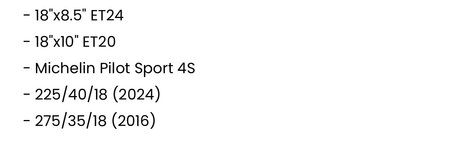

Hi everyone, what it would be a perfect wheel and tire setup for 500E rim size/offset and tire size, thank you
also eill thsese ones make a good fit?

The wheel size/offsets above are near perfect for the 500E. The rear is slightly aggressive.
However the front tire size is smaller than normal... should be 245 front matched with 275 rear.

yes this was listed on MB auction recently but it didn’t sold, and i was thinking to ask the seller what he is willing to sell them for
