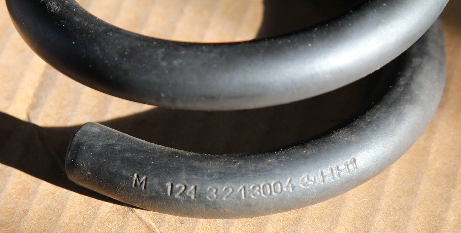

124 springs almost never "sag" due to miles, and if so they would not cause a car to sit very low. More likely is the springs currently installed were cut, or are not the correct part number. Note that old struts will cause the front end to sit lower than normal too. If you haven't checked the part number stamped on the end of the lower coil of the old springs, start there. Sample below.
