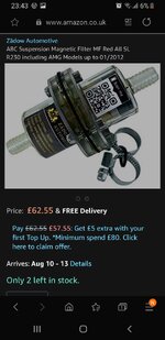

The same seller has these filters on amazon cheaper so I just went ahead and bought one
