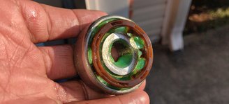

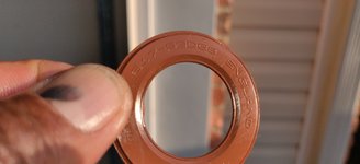

You have 2 or 3 choices in bearings. The economical choice would be VXB bearing.com which can sell you a front bearing (17X52X17) and a rear 6203 for about ~$20 + shipping. You can get the cheapest 6203 bearings are around a $1. You want ABEC 3 bearings which have a little extra clearance designed for electrical motors.
I decided to do hopefully better with purchase of bearings http://smithcoelectric.com/
Front Bosch replacement bearing is $39.95, rear I got a NTN for ~$6.
Brush/regulator I got a bosch from Autohaus az 1 197 311 213 for $27
Smith's also can sell you a new pulley ($38) or a replacement slip ring ($8.95) if yours is severally worn. Some times you'll need the plastic sleeve which fits the rear bearing(got to make sure you got it in the correct place on assembly!).

Now for the rear bearing- I used a cheap-o Cumins small 3 jaw puller. I've ground down the threads to prevent it from damaging the slip ring which is plastic.
To remove the rotor from the front housing. I supported the housing with 2 pieces of 2X4 and hit the top dead blow hammer. I put the nut back on flange out- to provide a hitting surface.
One hand underneath to prevent it from hitting the floor and breaking the slip ring.
Now To remove the front from the shaft- I used a screw driver to work the space off first. Then I ground down the Pittsburg bearing puller ($1.99 harbor freight onside) to fit behind. If there is corrosion on your shaft- might want to
hit it with 400# prior to using the puller.
