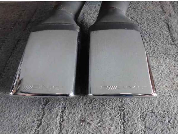

The W124 AMG exhaust came in 2 flavors - old logo (pre-merger) with oval tips and the ////AMG logo with rectangular tips. Forget about trying to find a pre-merger logo W124 exhaust. I bought the only two I have ever seen on Japan Yahoo and that was years ago for Jono and one of his customers.
Here is an auction for the later AMG exhaust
Price is about $1,300 (divide by 100 or so). Total cost with fees and shipping figure $2,000 all in. I would expect the P/N on this exhaust to start with "HWA" vs a stock 124 part #. Not an expert on post-merger AMG exhausts.

Here is an AMG P/N stamped W124 exhaust on Japan Yahoo. If you are looking for better provenance than the AMG plate welded to the stock W124 exhaust shown below, can you post what you think is "authentic"?
Opening bid about $800 plus all fees and shipping, probably around $1200-$1400

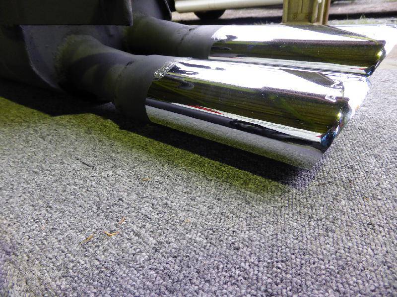

Here are pics of a nearly new W124 Hammer pre-merger full Sebring exhaust that I bought and had shipped to the US about 7 years ago. Will never find another like this! All in cost to me was about $2,100 - an unbelievable bargain in today's terms. A certain Atlanta shop owner was the lucky recipient of this rare find and this exhaust is waiting patiently to be installed on a Hammer sedan. Note that the Hammer Sebring exhaust is 2-in/2-out, while the post above is for the E500E single inlet.

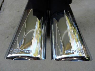

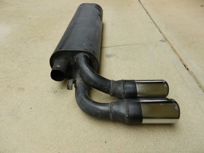

A W124 TE pre-merger AMG exhaust I bought and imported from Japan many years ago. This unit had some corrosion, but was very restorable.

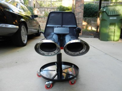

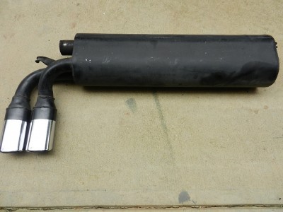

W124 AMG stuff is nice, but I prefer W126 stuff... Bought this many years ago and sold it to a French forum member who is restoring a 560SEL AMG w/ a quad cam 32v engine. This was listed on Japan Yahoo as a W210 exhaust. My winning bid was $75. Fees and shipping $300, media blasting and high temp powder coating $150. Helping mate this to an authentic AMG sedan, priceless.
