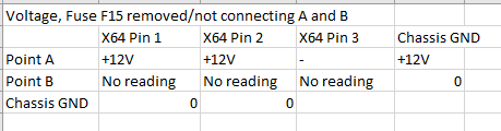

From the Diagram you posted, which of Point A and Point B in my image below is Pk/Gn and which is Bk/Gn? I tried to carefully remove some of the weather stripping black insulation that covers the wires and both are red below, not the colors in the schematic.
I also tried measuring continuity and voltage among some of the different pairs of wires with mixed results. I'm getting +12V between point A and Pin 2 which seems wrong, as does the continuity between Pin 2 and ground. I'm quite confused by the continuity between point A and all the wires though.

Not to beat a dead horse, but I had two cars that were not producing good power to the red wire on the three-prong regulator terminal (X64?).
One car had NO voltage. Another showed 12 volts on the multi-meter but it was not enough CURRENT to drive the fan even if sent directly to the motor. I went through several new regulators before discovering it wasn't the regulator or the fan. Bad ignition switches were the reason for lack of power to the red (and yellow?) wires of the regulator. There are no guarantees that your switch is bad but have you ruled it out?
When measuring power from X64, be careful about assuming the voltage you see on the multi-meter has enough current behind it. A bad ignition switch could fool you--it fooled me.
