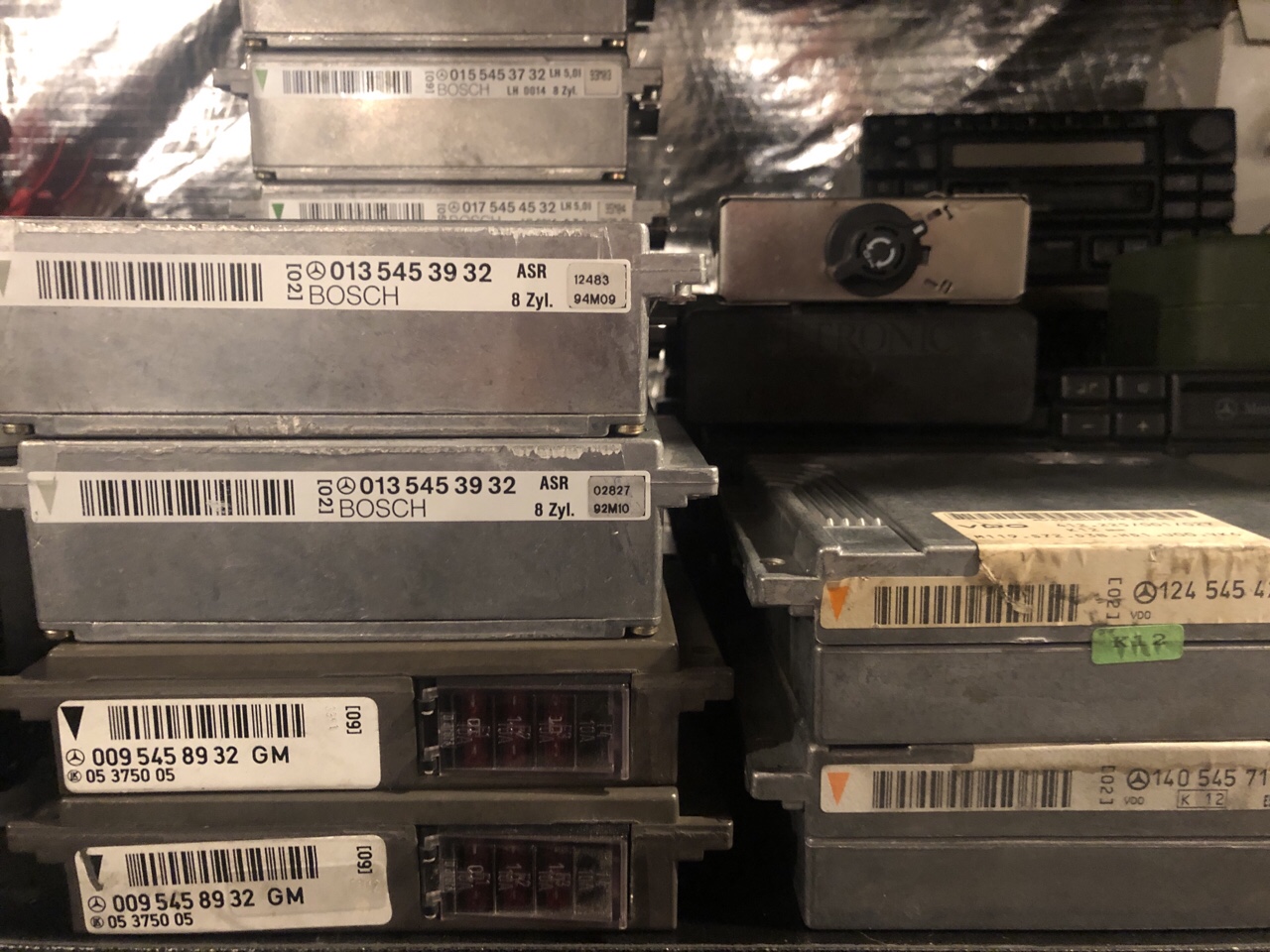

I believe I have a few spare ASR modules. I will check my basement shelves, and post photos of appropriate units.

Gerry that will be great if u can find one for me…!!!
