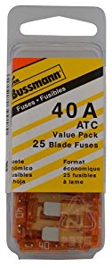

Thanks, Clark. I don't think I've ever seen a 40A blade fuse like that.

I've seen the 40 amp blade fuse on later K40 relays.

Some ofthe late cars have the orange 40A relay with, I believe, a 40A fuse. Need to see if I have one loose to get a better photo:
NOTE: Maxi fuses are physically larger, and are primarily used for ratings 40A and higher. The cube relays are smaller than the Maxi fuse.
Yes know about the maxi fuses, that what the K40 relay uses.
That's why I posted the second image of the ATC amp fuses, which are what the relay uses.

Get the 40 amp, the 30 has been superseded.
Thanks to both of you guys. I'll have a few of these on my next order. I actually did blow the 30A high-stage fuse a few years ago on a really hot (118F) day, so it would be good to have the extra protection. I guess they figured the relay and wiring could handle 40A. I went to O'Rielly's today but the only 40A blade fuse I could find was the bigger maxi fuses.
