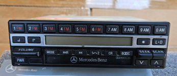

Folks - I have a BE1432 that is giving me intermittent issues. It works sometimes and then it starts giving me Error 2. I have replaced the head unit and replaced the trunk unit (got one off ebay). Also tried to check the 8 pin din cable. Today my stereo guy swapped the trunk unit and everything was working great. I came home and after a few hours turned on the car and again - Error 2. I am ready to lose my mind!!
radio unit clacking (relay sound) in the trunk ~5-10 sec after press power on, or not?
No - it is just static when I used any of the buttons like the volume control. Funnily enough the system has now started to work on it's own. Seems like it is fuc**ng with my mind :-)
In the meantime I have sent the original head unit and trunk radio to Becker.
No - it is just static when I used any of the buttons like the volume control. Funnily enough the system has now started to work on it's own. Seems like it is fuc**ng with my mind :)
if radio unit no click after press power on, check power wire, fuse and connector in first, after check bus cable
for power up unit, two wires are enough, BUS+ and BUS- (and power in power connector)
connect head and tuner pin to pin any short two wires for check without BUS cable
