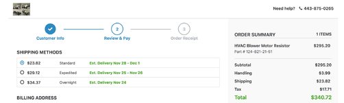

Indeed, both MB Classic and MB Annapolis are showing the resistor as available. I am going into the MB Annapolis parts department in the next hour, and will personally check availability via Paragon with the parts manager.

The Hicks price for the regulator is also about $16 less than MB Annapolis, as well. And MB Annapolis is one of the better priced RevParts vendors out there (better than MB Naperville, for example). For me the Hicks would be about a wash, because the shipping cost would be almost exactly what the difference in base price would be.

BTW This is what I see from SF Mercedes Benz -- SFBenzparts.com. I do local pickup from them so that I don't have to pay shipping, only sales tax. Their prices are competitive since I don't pay shipping. Its actually the same price as your Annapolis except for the local sales tax.

I just checked with MB Annapolis in person 30 minutes ago. They confirmed, via their Parts-b-Gone system, that there are six in stock in the US, most being in the Robbinsville, NJ warehouse.
@Jlaa and @gerryvz you guys have already figured this out, but yes. There is no discount from Ed Hicks. They will charge what the checkout page indicates.
Even with this, they still ended up beating Naperville on the total out the door.
It is possible that I can get a better deal with Ed Hicks because it doesn't look like they are charging any sales tax, whereas I am paying 6% sales tax. That said, the 6% is worth it to me to have someone local to deal with.
