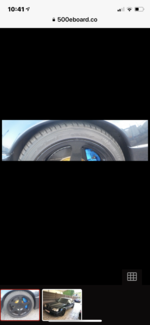

It’s an iOS browser issue and how it handles images displayed via Xenforo’s “Lightbox” function.
Many many reports are confirming this for both iPhones and iPads. Android based mobile devices are working fine — no negative reports.
Reloading the image got the whole thing. Never had it happen on a desktop browser. Ever.
I recommend switching either to an Android device, or desktop browser.

Odd and unfortunate! I love this forum, but not enough to dump my iphone. I’ll be soldering on with the desktop and partially loaded images on my iOS until whatever nitty OS bug rights itself. Perhaps never!
Thanks for the research.

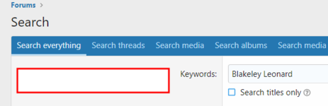

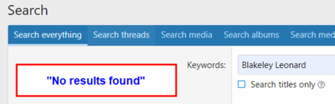

FYI. A search for that name does not find the thread with that name unless a wildcard is added to the end. (I didn't paste it here, because then the search result was showing THIS post.)
Thread / post #30:
