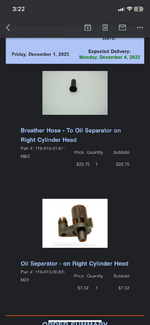

At least one forum member has had a broken piece of this separator drop into the cylinder head with no reported problems. I wonder if that part is even available anymore.
Before you use Pelican, might want to look at FCPeuro, Autohausaz or the local dealer or MBoemparts.com
You may find original parts from MB or better issue with the aftermarkets there. JUST a FYI.
