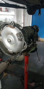

Yes the car is on the ramp will be removing the gearbox tommorow but noticed the exhaust is in the way
And the gearbox is out

What is the cause for that plastic piece to be “burned” like that? Was it ever low on oil? Correct transmission oil used and changed as per standard?
I hope everything else is ok, good luck with the repairs.
It was running fine well missing some spots and changes so I changed the oil and I think that ripped the ferodo off the clutches do u think this part need replacing and do u now we're I could ger a repair kit thx
