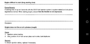

About length of starting time.... it looks like 4 sec cranking could be considered ok....
